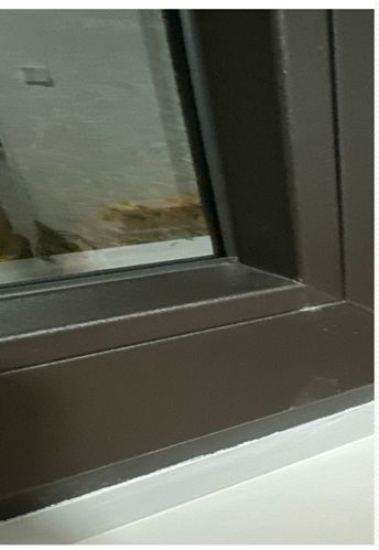

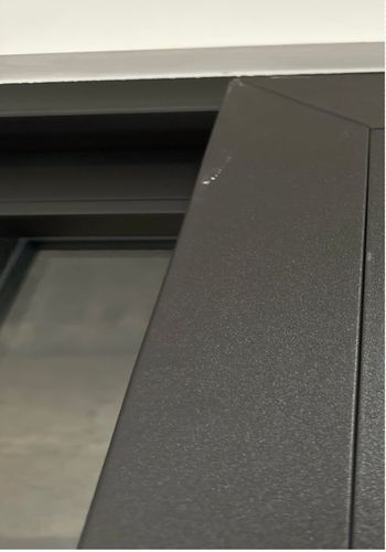

Can you suggest any products / methods for removing paint off my UPVC window / door frames?

Just to confirm, are you looking to remove the small specks of white paint?
If this is the case, I'd advise using a fresh Utility Knife Blade to gently scrape the paint off.
Make sure you wear some gloves to prevent any unnecessary lacerations while carrying out this work.

Hi @justin11
Before risking scratching the surface, I would try a magic eraser cleaning block and if that doesn't work I would try turpentine then methylated spirit but check the chemicals (Heck check the magic eraser too) in a place that won't stand out to make sure they don't damage the surface. Bear in mind that the chemicals may take a little time to dissolve the paint. I once got stain splatters on a colorbond fence when staining a pergola but managed to to clean it off (after it had dried) with methylated spirit.
