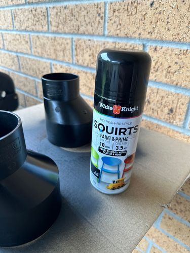

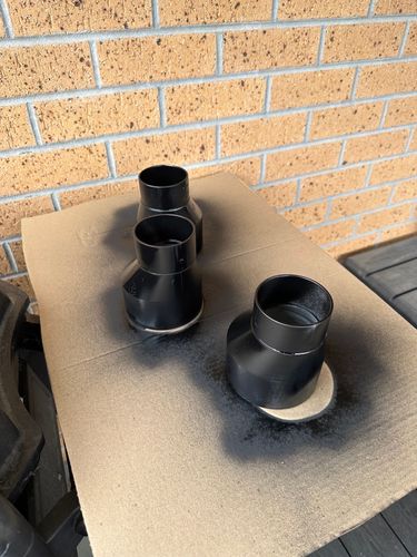

Step 2 - Get sprayin'
It's time to start spraying the PVC at this point. It's highly recommended to make quick sprays across the surface from around 15-20cm away from the surface.
I was pretty happy with this method and the final finish is pretty good for a first timer! I ended up going with about two coats as this particular product had a 10 minute drying time so it was easy to apply a few coats.
A few of my initial sprays were a bit too close to the PVC which caused the paint to run, so the 15-20cm distance is highly recommended for a quality finish.

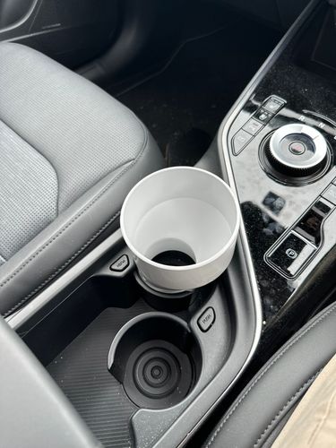

Step 3 - These bottles ain't going anywhere
This final step took some trial and error, but I really wanted to make sure that the bottles wouldn't move around too much in the PVC when driving. So using some furniture surface protector felt that I had lying around the house I cut off 3 fairly thin strips that I then stuck into the inner part of the taper fitting.
Now the first run of this was not ideal, this made the bottle far too tight and when lifting it out of the car cupholder, the bottle came out still connected to the fitting. So a quick trip to Bunnings and some thinner pieces of felt have absolutely done the trick.

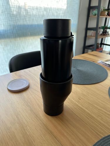

After a quick and simple bit of D.I.Y. I've now got my trusty 1L Frank Green bottle in my car finally!
