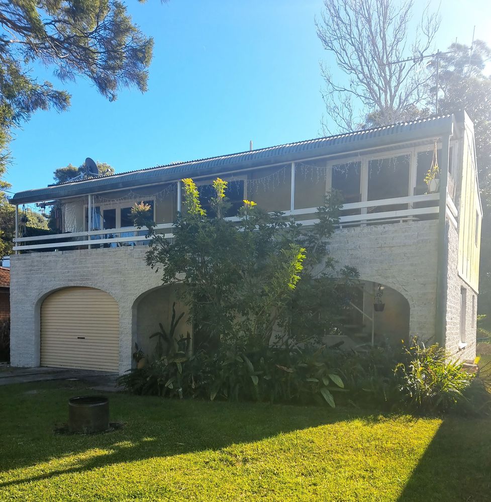

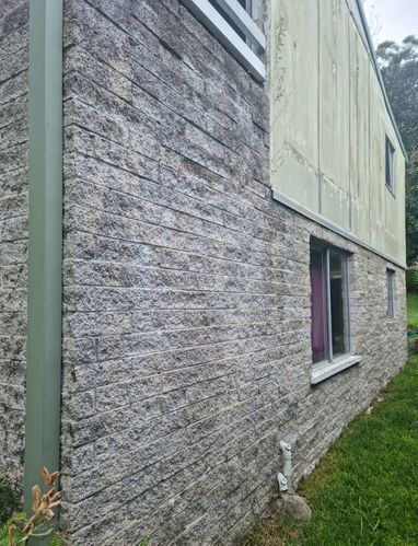

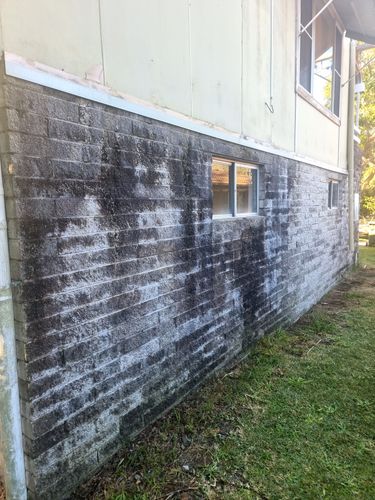

Step 1
1/7First i used 30 seconds outdoor cleaner and gurney although I didn't get great results.
Step 2
2/7I then used a mixture of of half chlorine & half water, left it for 20 minutes before gurney the bricks clean.
Step 3
3/7I then used 1 part hydrated lime and 4 parts water and painted it on with a fence brush.
Step 4
4/7I allowed it to dry and cure over 48hours.

Re: Limewash brick house
Hi @Herrenovacation,
You have really done a fantastic job brightening and giving new life to your brick home. The stone hidden underneath all that dark matter just needed your love to shine through and improve curb appeal. Great projects like yours sometimes make it into our Top Ideas section like our 10 ways to improve your home's street appeal. You never know, you may find yours in there one day!
Thank you for sharing your project with us and we hope you continue to find Bunnings Workshop as a great source of inspiration and helpful advice.
Katie
Hi @Dave-1 sorry for not responding sooner.
Yes I wanted it to look fresh but not stark white like everyone else in the suburb. The bricks/house is quite different and I wanted to keep it that way.
This was my first time using limewash, I can't remember where I got the idea but I looked into it and heard not only would it brightened up the brick it might also stop the mould/algae from growing back which it has. I have also seen it used on red bricks to change the look/ wash out the colour as well.
I am not sure of the total cost but it was more expensive to clean the bricks/house than it was to paint it. The hydrated lime is only $14 from bunnings and you just mix it with water so its really cost affective. It will likely need to be refreshed sooner than paint would but I can live with that as I still have so much lime leftover and I love that my place still has that old house charm.
Only advice is be careful where it spills as its not noticeable until dry. ( I wasn't to worried as this was my first project and i want to re tile the patio etc. )
Afternoon @Herrenovacation
Thanks for the info. Might give it a try on some bessa block walls I have on my driveway.
@Dave-1 make sure you thoroughly wet the bricks/bessa blocks before applying the limewash. I did one coat let it dry, then decided i wanted a second so wet it again before applying second coat. Would love to update the project instructions but not sure how to. Wetting it does make it harder to see where you have applied it and where you haven't but when it drys it looks so good.
