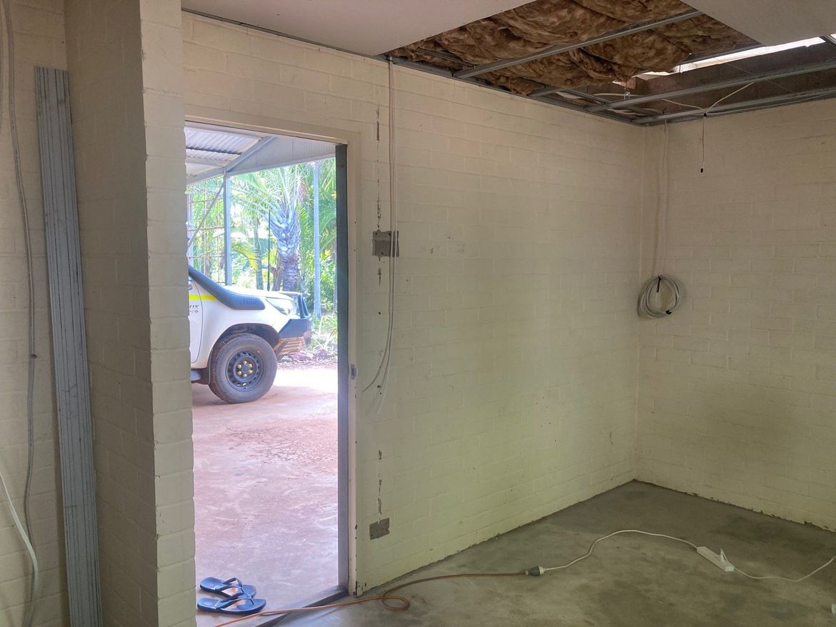

We’re currently renovating a guest room that’s attached to the main house. 3 walls are external, however thy are protected from the rain. They are single brick walls, no insulation, cladding or plasterboard. Just painted on the inside and bare brick for now.
We want to insulate those walls from the inside (R2 insulation) and install plasterboard over it. The big question I’m asking myself is whether we need a vapour barrier or not.
I’ve spent hours seeking information about vapour barriers, unfortunately no luck yet. I’m confident that is going to change now!
Any help is highly appreciated. We live in far North WA, close to the NT border. Dry warm winter, wet and hot summer.
Thank you very much for your support!One of the three external wallsOne of the three external walls

It sounds like you'll be building a timber frame inside this room to hold the batts in place. I think installing a vapour barrier is a practical step as the cost of it won't be that significant and it adds a safety barrier for your insulation. But it's advisable to consult with a local building professional. They can provide guidance tailored to your region's requirements and best practices, ensuring that your wall design effectively addresses moisture management and complies with any local regulations or standards.

I am thinking that it cant hurt with a vapour barrier then insulation and an internal frame. I wish I had installed a vapour barrier when I retrofitted my garage as I found out that thereare fine cracks in morta and bricks even if you cant see them lolIts not a biggie but as @EricL said  "it cant hurt"

That's a very good point with the cracks in the brickwork! I'm wondering it it'd be helpful to coat the outside of the brickwall to stop the water from entering the bricks at all?

Preparing the wall before you cover it with a frame is a prudent step. By eliminating all possible leaks in the wall, there will be no surprises when you install the timber frame and seal it up.
