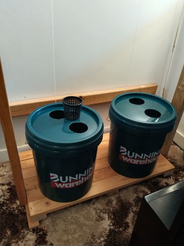

This is the new system with the new containers that I'll be using for the transfer of the plants.!! 😁 Good old Bunnings !!

That's looking pretty sharp! I see two holes in each pail, does that mean two tomato plants in each pail? I love the string climbing set you've prepared for the plants. Your plant's growth is surprisingly fast or I've just not noticed the weeks flying by.
Looking forward to the next update.

The two holes in each pail are for different plants..
The back two holes will have the tomato plants and they will be right next to the stringers..
The front two holes will have a Capsicum plant and a Lebanese Cucumber  plant..
The two Mason jars will have an Iceberg lettuce and a Bok Choi plant..

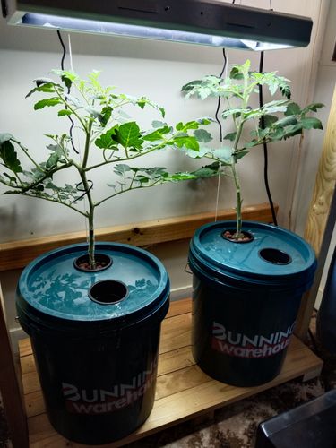

Firstly the tomato plants have reached their full height and are starting to show some flowers..Unfortunately there's a problem with the blooming..
Reading up about it..It appears that I need a different nutrient for the flowers to change into fruit..
Here is the latest photo of the plants..

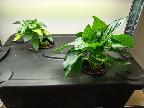

These are the capsicum plants..The one at the back nearly died but I was able to recover it.. It's just been a bit slow to grow..

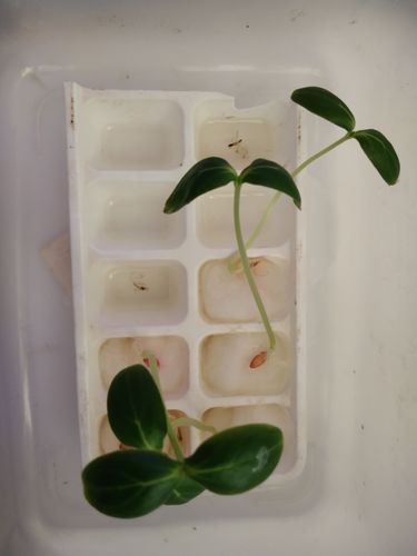

And in the seed nursery we have some strong growing cucumbers that are growing in cotton wool balls.!! and a variety of lettuce growing in a different medium..
It was a bit of an experiment to see if they would shoot in the clay medium..and they have.!!

Indoor lighting needs to be considered. I can't tell if you've specialist indoor plant lights or not - but if not - you should be. Light spectrum is really important because plants need different lights to humans. Light at the blue end of the spectrum for growing and at the red end of the spectrum for fruiting and flowering. Commercially they may change the lighting for different parts of the life cycle. Your tomatoes do look a bit 'leggy' and lighting may explain this

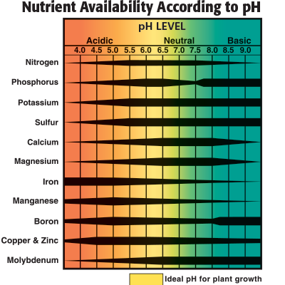

pH Adjusting: great that you are regularly checking your pH and adjusted regularly. The pH affects availability of nutrient take up, different elements are taken up at different rates at different pH levels. Google 'Truog Chart' to understand this better. Would note though that pH for soil and soilless media are quite different. There is less buffering when not growing in the soil. Liquid pH adjusters are required for hydro and they do work faster.
