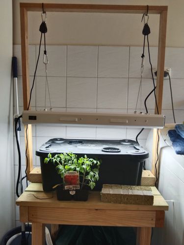

And finally the lighting system is in place..

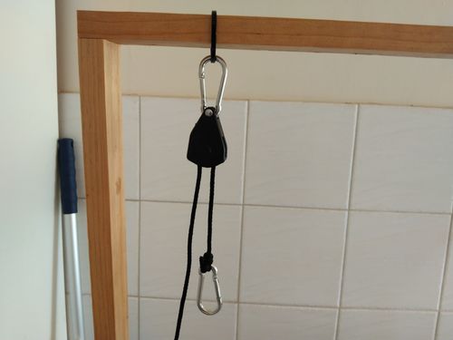

Those little black devices are miniature hoists.!!IMG_20221111_140030[1].jpgIMG_20221111_135600[1].jpg

Thank you very much for that update. That looks to be an excellent method of adjusting the light. Once the plants begin to get taller you can simply pull on the rope and the lights will go higher.

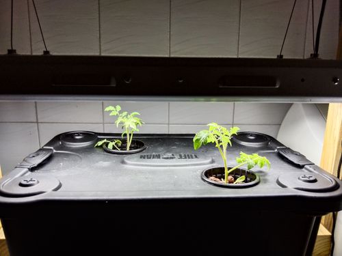

IMG_20221112_132047[1].jpgWe have hydroponic tomatoes under way.!! 😁

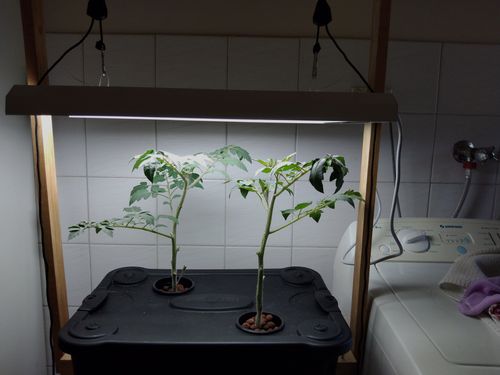

Here is a photo of the growth currently..If you compare these to the original photos you can clearly see the increase in growth..

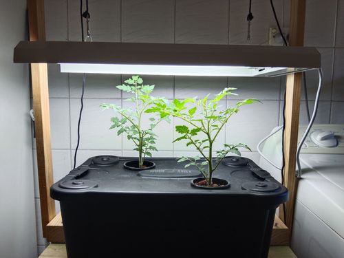

It's now the beginning of week four...
The plants have continued to grow..now with the addition of the full strength fertilizer..
Initially I had a problem..The leaves were starting to curl a bit and the plants were losing some colour..
I had set the pH level to just under 6.0 when I first added the full strength fertilizer..I took the pH reading again three days later and it registered 7.7.!!!
I don't know what happened as I had taken the reading the same way as the first.!! I immediately dropped it back to 6.0 and after a couple of days they started to come good again..

Here is a photo of the plants in the original tanks that shows how high up the growing lights are now.!!
I've also trimmed the plants to remove unnecessary stems and leaves which will help to keep them away from the bottom of the plants..
