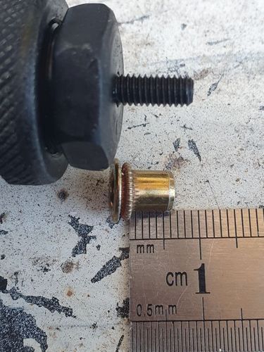

Many good ideas above. I was wondering if a nut rivet would be useful in this situation?
Re: How to replace screw that will not engage?
Well @Noyade you are correct a Rivnut would simplify the process but would require yet another specialised tool, whilst I fully support collecting tools, a flat head bolt doesn't require anything beyond what a DIYer would already have on hand 👍

At the time I was thinking if the de-threaded hole is already there - fill it with a nut. 😁
