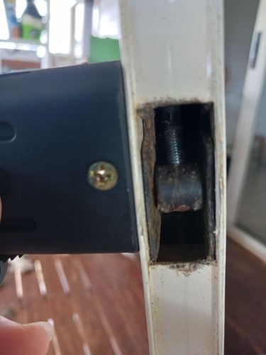

So I made the mistake of watching YouTube to find the answer to my screen door problem and used a screw driver to get out the runner bracket part but now I can't figure out if its an easy replace the broken bracket and runner or if its a real stuff up and there's a thick screw inside that I think was holding the runner bracket In place and the screw to undo that has been threaded and can't come out.
The only solution I can see is to take it to a door place and get it all fixed up.
Is there a way I can fix it?

I took a photo of it. It doesn't fit which is strange given it shows it fits according to the measurement on the website from the link.
That spring won't go back far enough for it to fit in given how long the bracket is. I'm not sure if it's jammed. Maybe some wd40 would move it further back.

You'll need to remove the plastic housing of the old screen roller in order for the new set to fit in. If the opening is a bit small or needs to be bigger, I suggest using a steel file to grind away the aluminium to make the hole bigger. Your goal is to clear the bottom of the sliding screen of the old screen roller housing and test fit the new rollers you've purchased. I also suggest looking around the edges and see if there are any screws that are strategically placed to hold the old housing. If you find one take it off and see if the housing comes out. The last option of course is using brute force or cutting the old plastic housing out.

Thanks Eric there are screws on each side but they have been completely destroyed from someone trying to get them out. Possibly the old owners.
Do you mean the plastic housing from the last rollers? That has already been removed. What is left is a large screw and something attached to it, as the photo shows.
Some of the photos in the thread show what is left inside the roller housing area that is blocking any new roller from fitting in.

I propose using either a Trojan 300mm Mini Hack Saw or a Multitool to cut the screw that is in the way.
