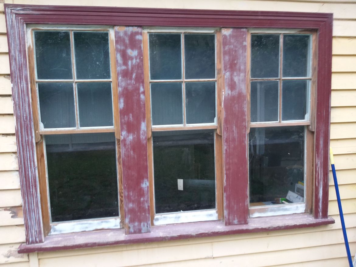

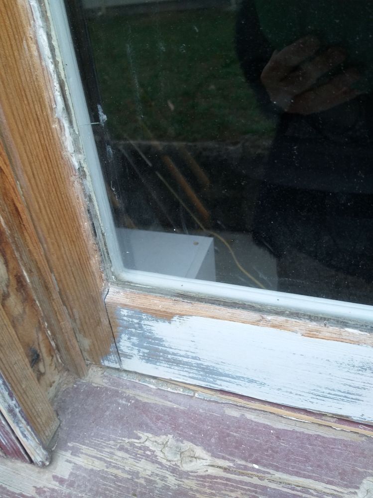

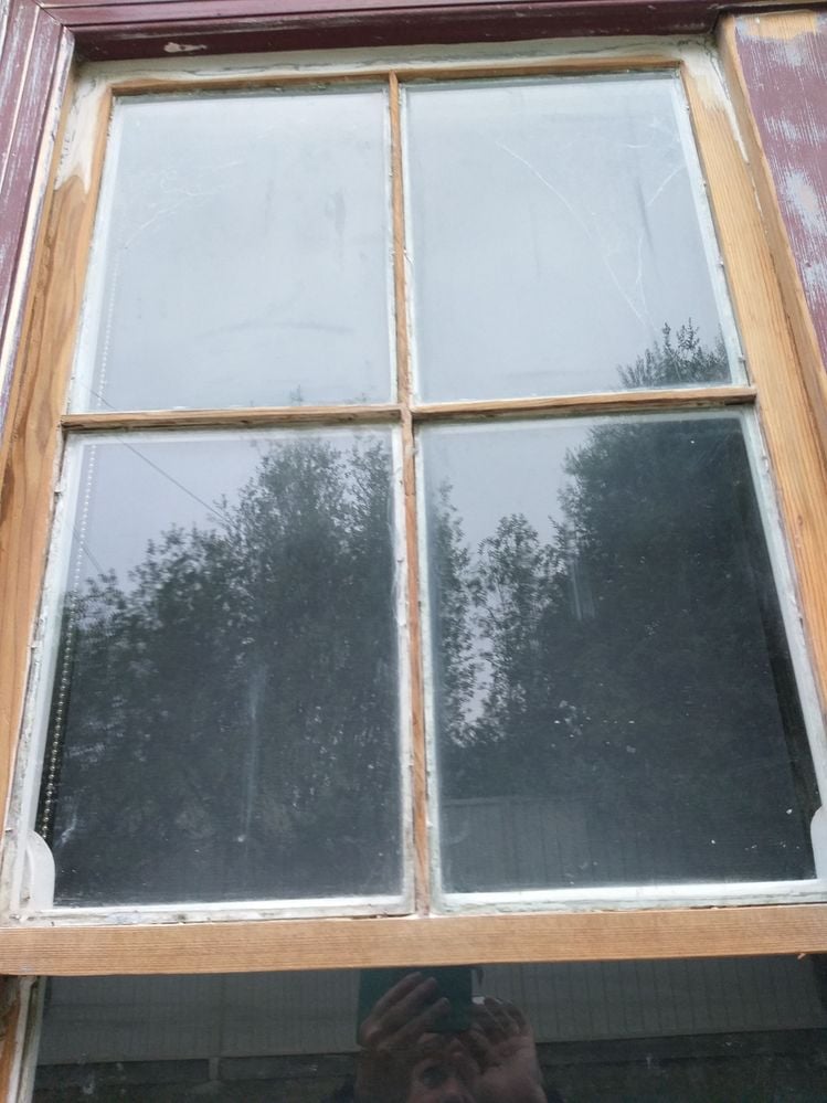

Good afternoon, I am in the process of repainting the exterior of my 120 year old house, and have a few questions in relation to the windows.  I have removed all of the old putty around the windows and have sanded.  After doing some research I believe that the next step is to paint the windows with an oil-based primer.  Then once the primer has dried, apply a linseed-oil based putty.  Can anyone advise the best primer and putty to use?
Once the putty has dried, do I then need to repaint with the primer? Or do I just need to undercoat when undercoating the rest of the windows.
Also, if I am using an oil-based primer can I use a water-based paint when painting the windows?  I plan on using a water-based paint on the rest of the house as I find this easier to work with.
One final question, is Dulux Weathershield the best exterior paint to use or is there a better product to use?  I have heard Resene or Haymes are also good.
Sorry for all the questions but I don't want to have to repaint again for a long time so want to get this right.  Any advice would be appreciated. Cheers

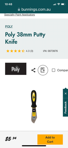

@lisajk, excellent advice from @EricL as always, if you haven’t puttied a window before, you will need a putty knife or similar, also you will have to nead the putty before application, it makes it a lot easier to apply. I suggest looking at YouTube videos on line on how to install the putty.

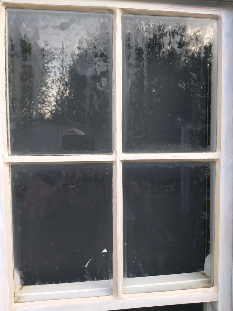

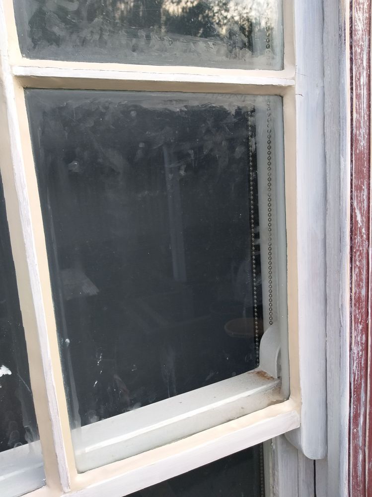

Just thought I would update you on my progress.  After applying the primer a few weeks ago, I finally got around to using the putty.  Not completely happy with the result - a bit lumpy and I had trouble getting the corners smooth.  But for my first attempt I don't think I have done too bad.  I will now leave if for 3 weeks and then apply another coat of primer.

Thank you very much for the update, the putty looks very well placed. As long as the glass is properly sealed a bit of bumpiness should not affect its performance.
Please remember that rainy days will slow down the curing time of the putty.
