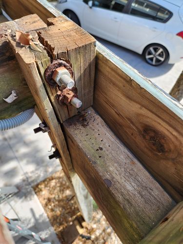

 Hey team, I have a 265 x 65 bearer that spans 5.4m on a balcony in front of my house. The bearer itself started to split so purchased some replacement timber. Currently the bearer is connected to the post with a VERY precarious looking notch that is bolted to the bearer. I was looking at doing a flat connection for the post to the bearer but I don't seem Australia using the Simpson strong tie brackets. So with the hardware available here, what would be the suggested way to connect the bearer to post?

Given the height of this balcony, I'd highly recommend you consult with an experienced professional on appropriate connection methods. I would imagine that the solution would be something along the lines of a solid steel plate on both sides of the posts that extend up onto the bearer. Bolts would pass through the plates and sandwich the post and bearer between them.
