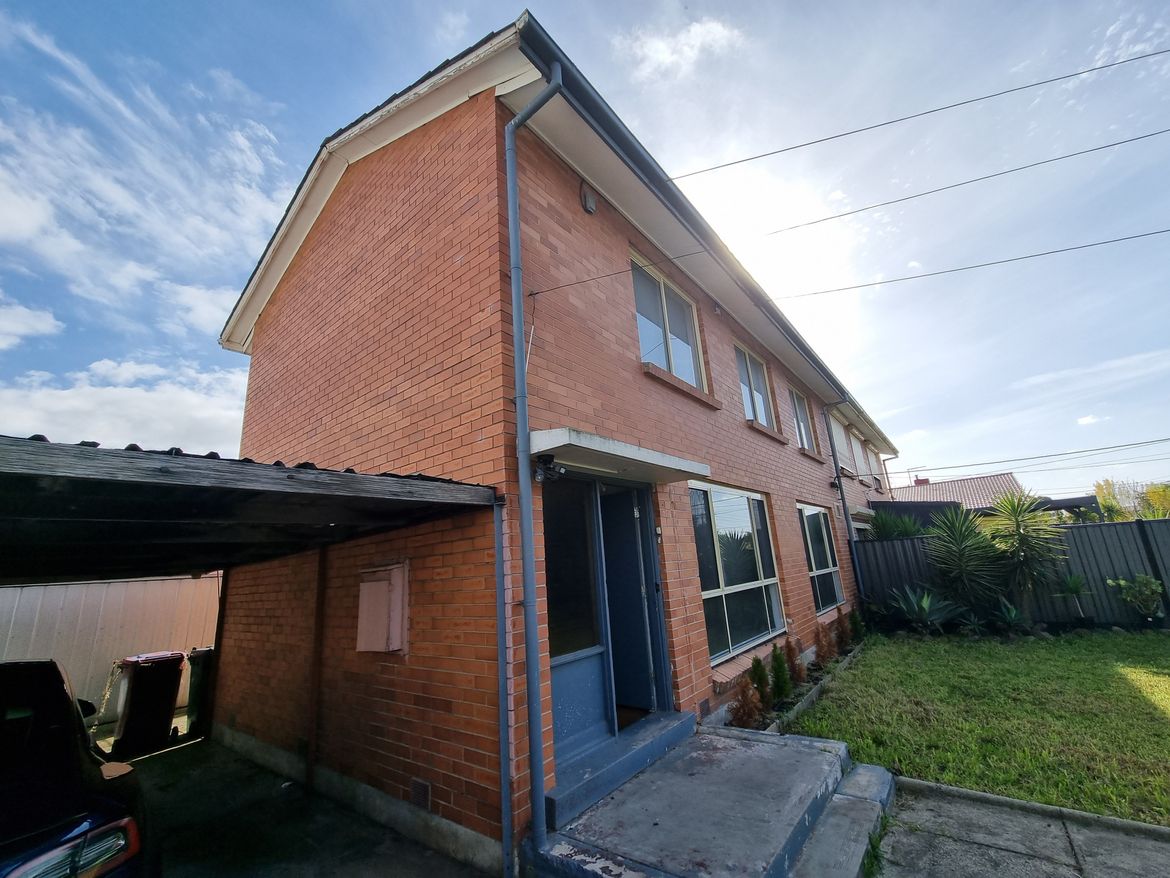

How to render an external brick wall?
How to do rendering of external brick wall of a house? What types of material to buy? How to calculate the amount of material? What's common errors of rendering that cracks quickly? I intend to buy material and hire good people to do the labour work.
Should the electrical wirings, or conduit pipe to be dismantle from external wall before rendering? There are down pipes, plumbing, and electrical wire on the external wall before rendering.

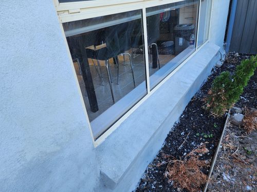

thanks. Cement Rendering over the brick wall and wait for the top coat to be done
Re: How to render an external brick wall?
That's looking great, @Honest52! Well done.
Many thanks for sharing your update, and we can't wait to see the finished project.
