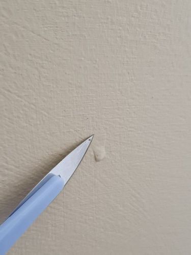

I'm presently painting and doing a very poor job of it - as usual. But I've been experimenting with a curved scalpel on similar paint droplets. The trick is not to let the paint dry and harden - so that while it's still relatively soft, you can slowly debride layers until you believe you've reached the wall surface level. The scalpel must be sharp - and curved is better than straight.
Then re-paint.
One step back after re-painting...
Cheers.

Problem is that this one did not show up till the paint dried …I kept looking it over when painting and these were not there …when I tried taking it off the next day it was like Mitchell said ,still soft underneath and did not flake off like the one in your pic
I will though keep your suggestion in mind when I paint the walls

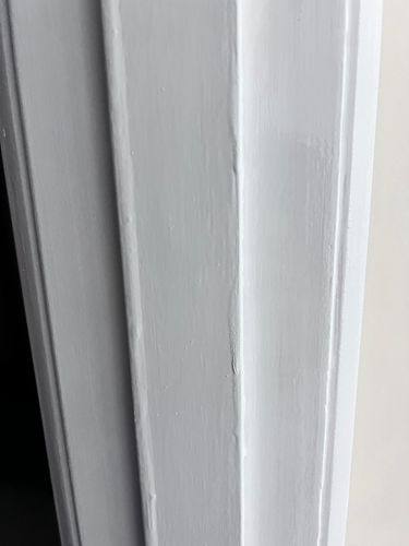

Ok..so go time to do this ..and here is how I got it done..I could have sanded it but it took long as the paint was sticky and came off like glue comes off when you rub it …here is what I did
first I sanded it down light to look like this (80 grit)
Then I sanded it down again (120 grit) to get this finish ..painting time 😃

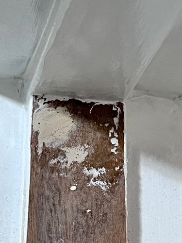

question : what other ways can I use to strip stain off the architraves/skirting boards ..here is what they look like ..I don’t mind sanding but I have kids at home and worry about the fine dust flying around ..is there any better way ?
Re: How to remove thick paint deposits after painting?
So, you don't need to sand the varnish entirely off @Mark270481. You just need to scuff it up so it's not glossy anymore and then prime it with something like Dulux One Step. As you're not having to remove the whole coating it will cut down significantly on the amount of dust floating around.
