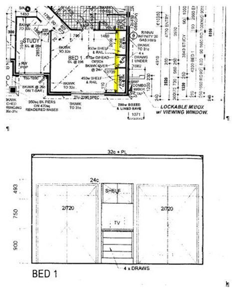

We are in the process of renovating our main bedroom, we have a built in robe along one wall, from what I can see from the plans it is not a load bearing wall, it appears to have a lintel across the top of the wardrobes and opening in the middle. We are trying to think of the most cost effective way to get this removed. If we get permission or the okay from a building inspector that the wall can come down, is this a DIY job? I understand I will eventually need a brickie to cut the bricks on either side of the wardrobe to make them flush with the side walls, and also need a plasterer and gyprocker to fix the ceiling. Hoping that we can do some of the demolition ourselves to help cut back costs? Any advice or suggestions would be appreciated.

Assuming the building inspector gives you the go ahead that it is safe to remove this wall, then demolition of a wall is a fairly easy process that is absolutely doable as a beginner but there are precautions that should be taken.
