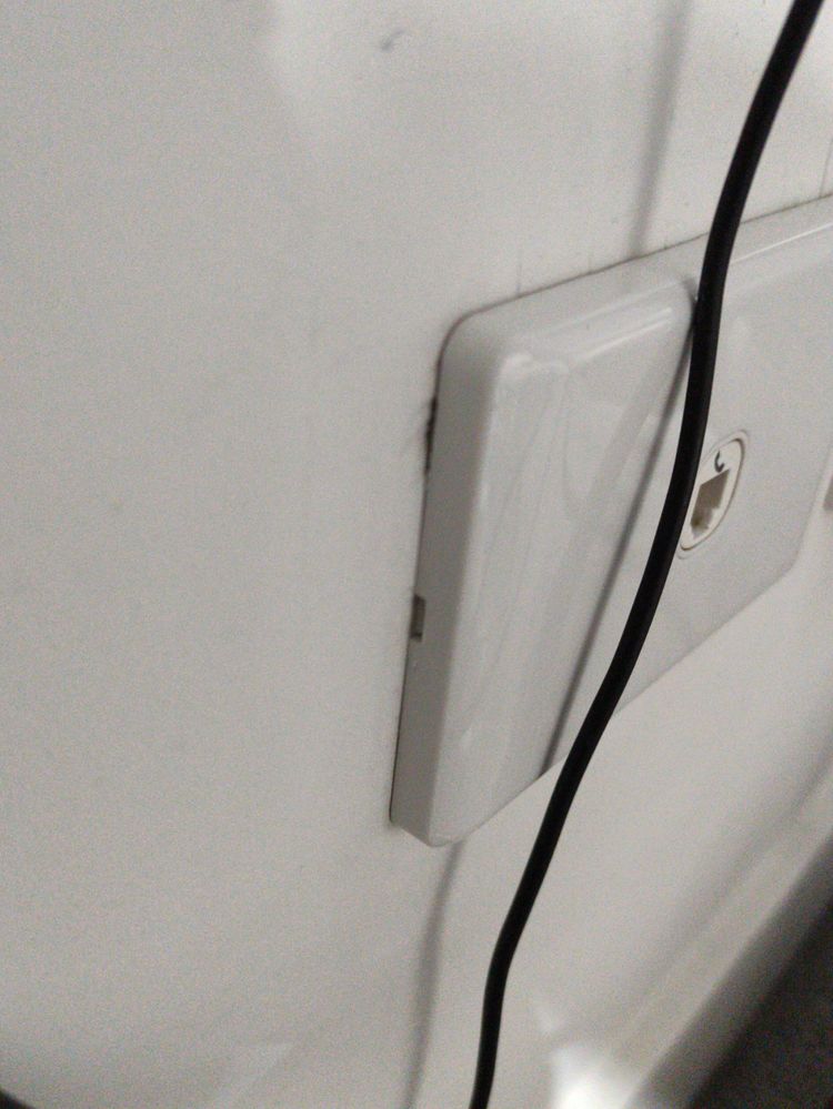

Okay, this might be a silly question... But, I have these screwless outlets in the apartment, and I can't for the life of me remove them! What the hell?! There are 2 tiny button-like notches that I've pressed with a flat-head screwdriver, but the thing still won't budge.
What am I doing wrong here? I've tried to pry it open as well but slightly damaged the drywall around in the process already. Surely this isn't supposed to be this difficult? I want to see what cable is used in there.
Hi @Kazur , interesting that the front plate won't pop off, since that is the only way I've ever come across to get at the screws. The cover is thin, so don't put the screwdriver in too far. Also place a piece of thin metal or plastic (such as a scraper) on the wall to lever the screwdriver against without it pressing directly onto the plaster. Try levering at the corners.
Alternatively the slots may be to access some sort of catch, so maybe it's not levering but firmly pressing inward with thin driver that's required.

Generally, you should be able to place a screwdriver in the notch and flick the cover plate straight off. Instead of the wall, you might need to use something else as the fulcrum point. Take a small flathead screwdriver and place it into the notch. Put a thin strip of timber or bunch up a tea towel and place it under the screwdriver. Lever against the timber and pop the cover straight up and off. You might need to push in on the tab at the same time. I've created the rendering below to illustrate.

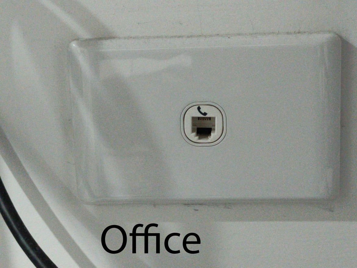

So I was able to open the outlet and see what cable is in there. I'd like to change the socket from RJ11 to RJ45. I know I need the following product to replace the office room outlet https://www.bunnings.com.au/hpm-excel-1-gang-rj45-port_p4330573

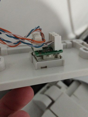

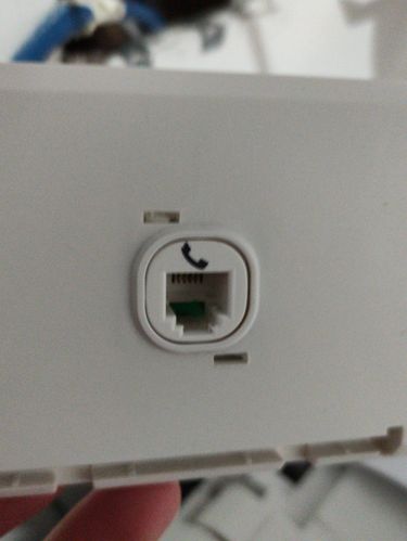

Any tips on how to pop the RJ11 jack out? I want to take the outlet with me to Bunnings to make sure the RJ45 one you suggested fits. Here are some pics I took. Do these notches here have anything to do with it?
