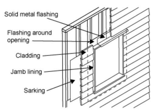

Hi @samh25
Your have two neater options in dealing with the sizing issue of the window reveal (frame).
1. Buy custom (very expensive).
2. Mark and cut the excess off with a saw.
The 2nd option I have done several times, especially during a COVID reno when I had to take what I could get for materials. I used a circular saw fitted with a guide fence on a min depth setting to pass through the frame thickness and had it very well secured. You could also use a Jigsaw which is a safer option for the less experienced. And of course a short sharp hand-saw. Just flip the window for each side,
Below is a diagram to explain. your flashing installation.
