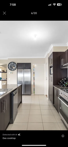

Hi all,
we recently purchased a house and we want to change the floors from tiles to hybrid floors we have been quoted to install 7.5mm hybrid and we don’t know what preparation we need for this floors. We don’t want to remove the tiles we want to put the hybrid on top.

Hybrid Vinyl Plank flooring can be installed above any type of existing flooring. You'll just need to make sure that your tiles are reasonably flat and any damaged tiles are repaired or replaced before laying the flooring.
