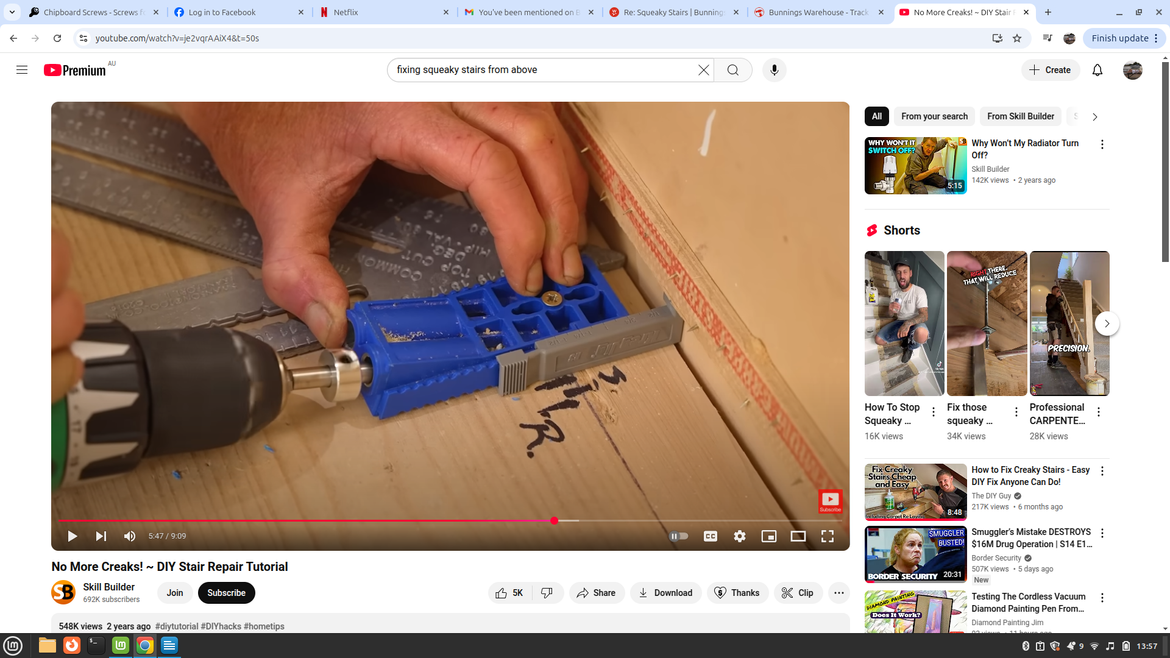

I was hoping to drill pocket holes from the thread into riser, after removing carpet the stairs are creaky.

I was thinking of using Kreg jig at the back of thread joining a riser and then if required trim head screws at the front to join thread & riser?

Hi @Nanne,
I'm not sure I completely understand where you are planning to screw.
Can you mark on your photo where you are planning to put the screws?
I can't really see a way that a pocket hole screw would be usable at the back of the tread as risers sit on top of the tread. Did you maybe mean you would drill sideways into the stringer?
Squeaking treads come from friction with the surface beneath, so the standard way to address this issue is to drill down through the top of the tread into the support beneath. Drilling sideways into the stringer would likely help this.
Let me know what you think.
Re: Squeaky Stairs
Re: Squeaky Stairs
Hi @Nanne,
Apologies, I understand now.
Assuming there is sufficient material behind that back edge of the tread, then this should help.
Definitely worth a try.
