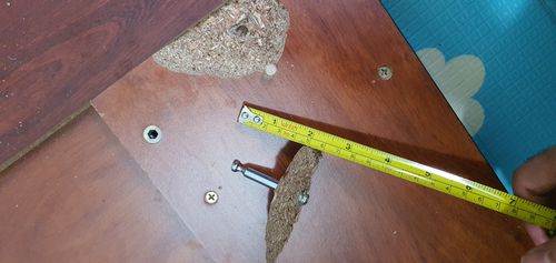

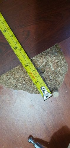

Hi guys,
I really need help with fixing my office table leg.
It's a very heavy particle board and I was about to move it then a chunk of it with screw in it, came off(photos attached)
Not I can't install the leg back
Any suggestions would be really appreciated
Thanks
Sam

Certainly a big chunk came away from the desk-top underside.
Is it under warranty?
If that happened after simply just lifting the table - a stronger connection is required.

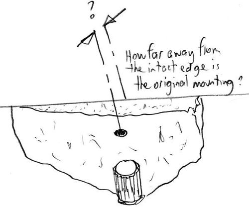

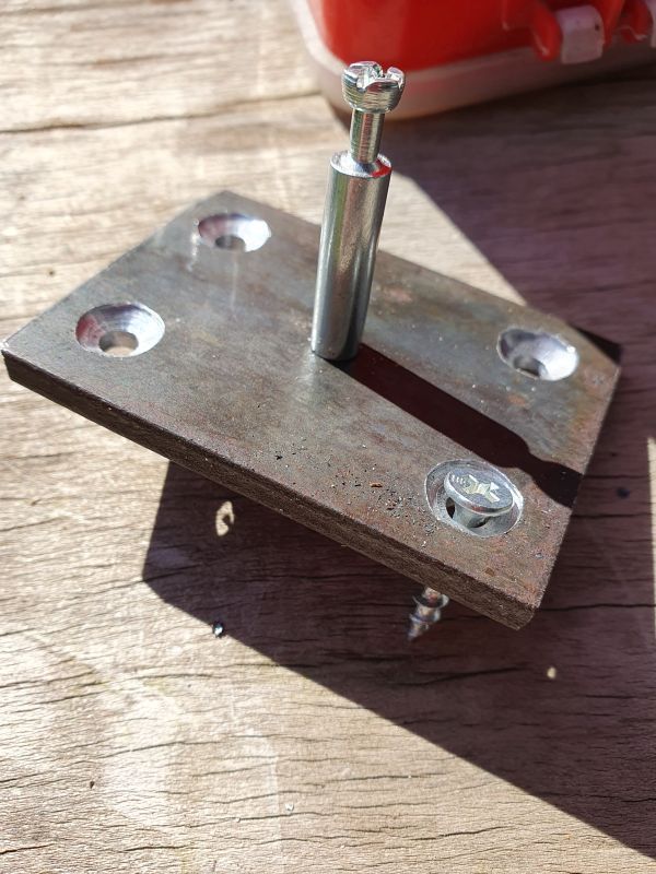

If you're good with a hammer and chisel - chisel out a small area so that it's flat and deep enough to accept a piece of 5mm steel plate.
This plate has been drilled and tapped to accept the male side of the connecting rod - with countersunk holes for small screws. That rod is never going to come adrift.
Position it as required.
Screw in position (how thick is the desk top?).
Fill the surrounding areas with something like Builders Bog. And maybe brackets as per @EricL ?
I'm happy to mail this to you - or make a smaller base if you give me dimensions. No cost - call it the Bunnings Workshop Community Spirit. 😁
See what you think and let me know.
Cheers!

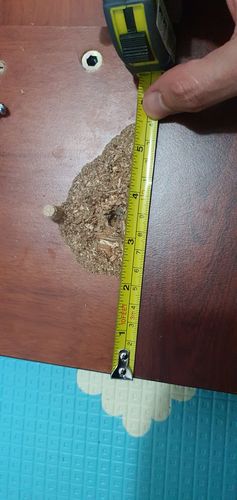

Hi @Noyade
Thanks for your offer.

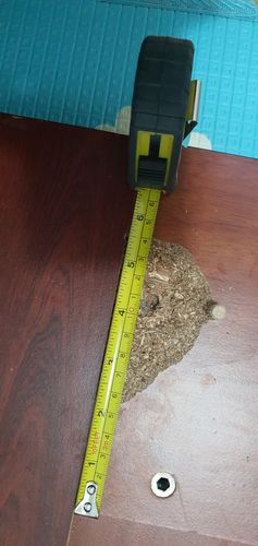

For sure I need something sturdy. Do you think I can use what you suggested based on the dimensions in these photos?
Re: How to fix particleboard table leg?

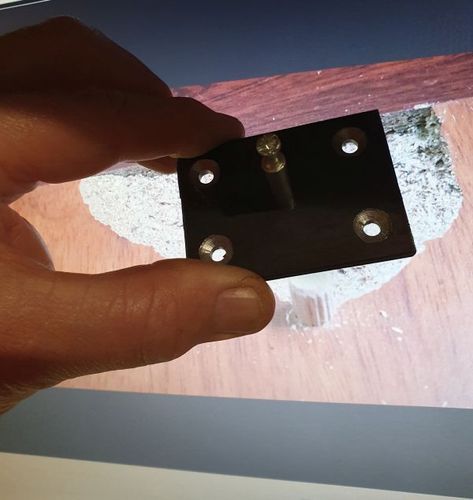

Hi Sam @Samnet
The bracket is 50mm by 67mm - it was just a piece of scrap I had handy. I just made it quickly to show you what I was on about and I'm not suggesting this is the only solution to your desk problem.
But I can make the base whatever dimension you want.

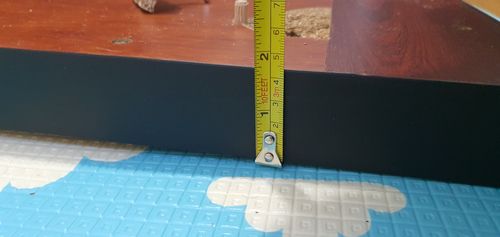

Again I ask - what is the thickness of the desk top? You definitely need enough space for screws for this method - otherwise all of the other ideas above may suffice.

Thanks @Noyade
I tried to take photos from different angles to give you better idea of the size and if it works for me or not
