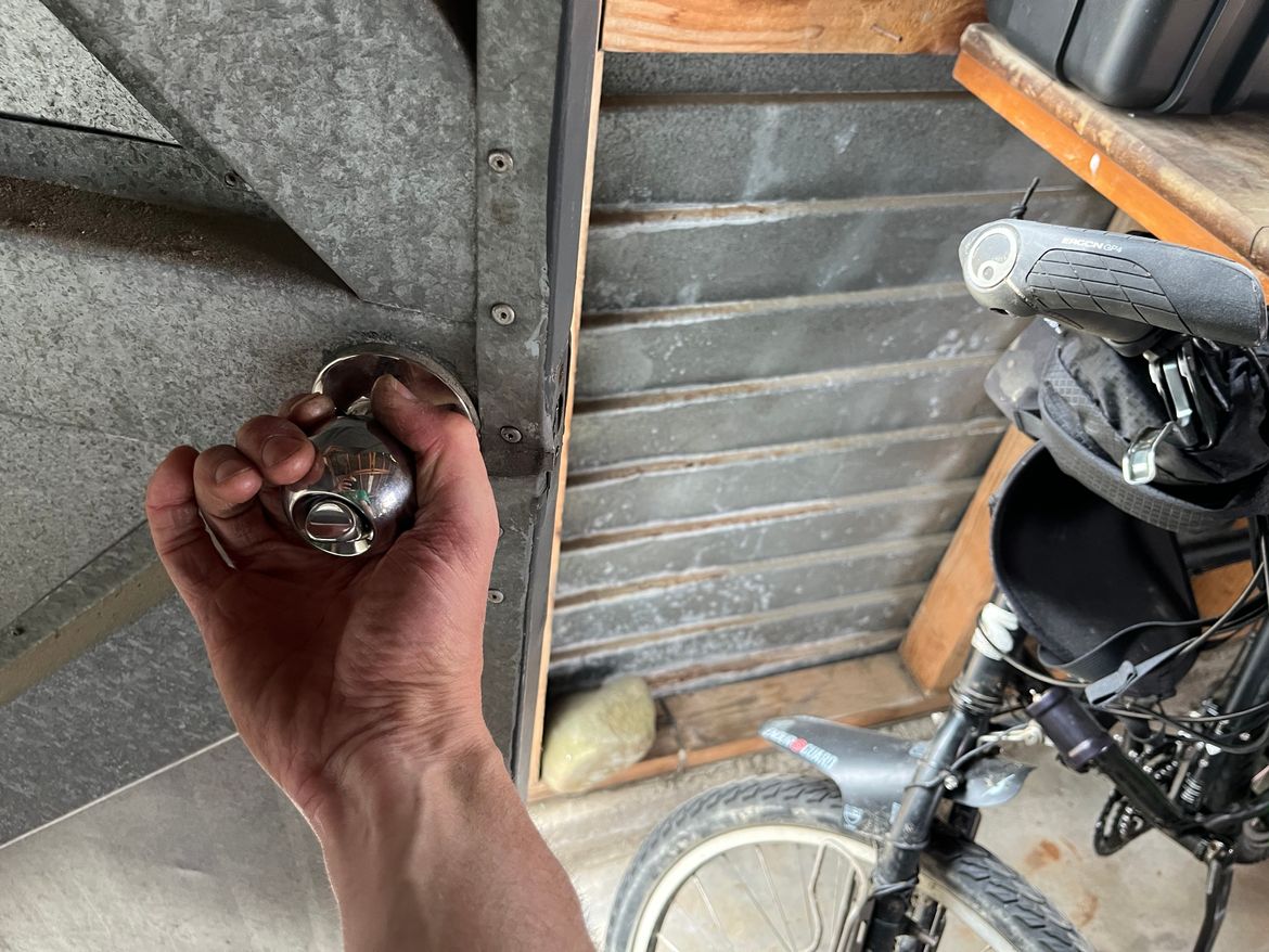

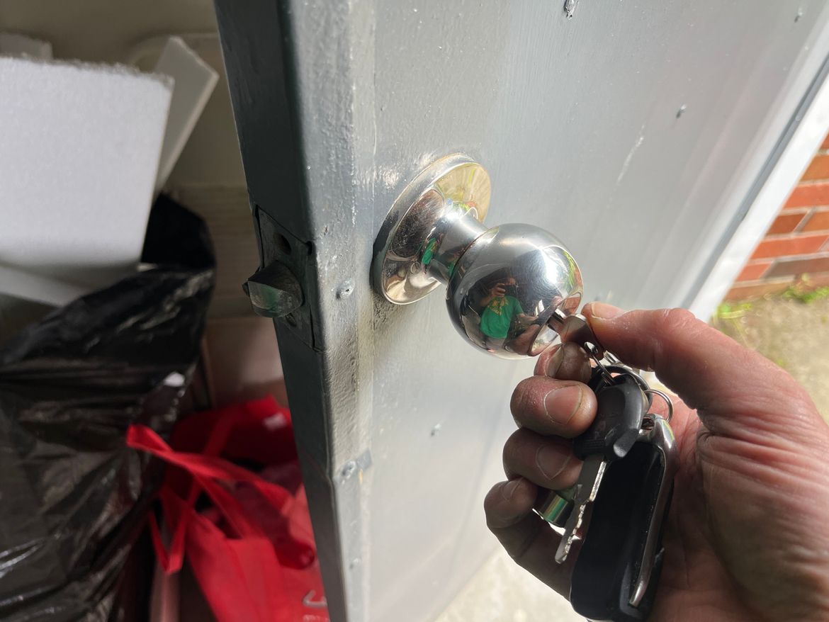

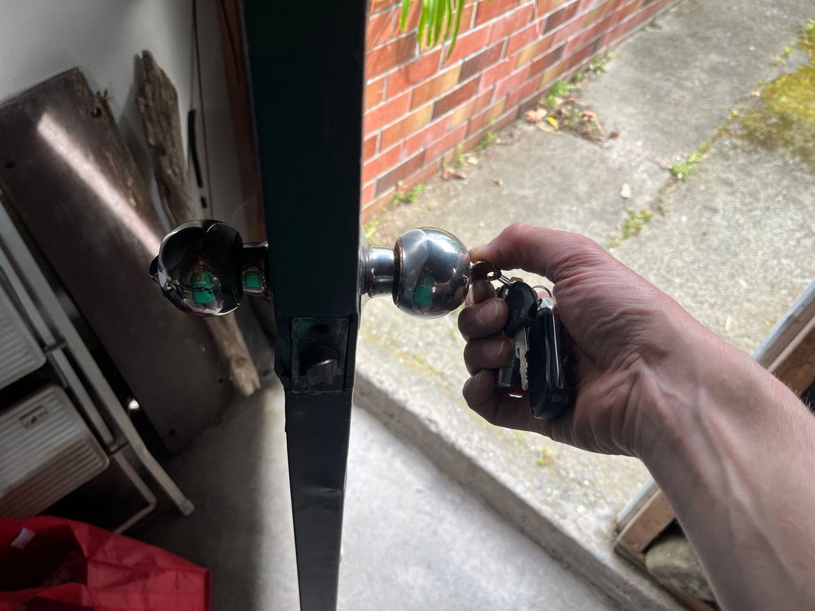

The regular door on my garage is not unlocking, so I currently have to enter my garage workshop via the noisy and public roller door.
Initially the key wasn't going in at all. This was resolved by spraying graphite powder on the key and in the key opening and moving it around with the key.
Then the bolt wasn't sliding past the door frame plate. This was resolved by rubbing graphite powder on the bolt and door frame plate.
Then the snib wasn't rotating freely. This was resolved by removing the handle on the inside side, spraying graphite in then blowing it out and around with compressed air, and also by removing a chunk of wood that had found its way in there somehow.
So the lock is now well lubricated. I can lock and unlock the door from the inside. I can pull the door to when it is unlocked, with or without turning the handle, or when it is locked (when the handle doesn't turn).
But I still can't use the key to unlock it from the outside. What am I missing?
Note that I am living in a rental which the garage is part of. So I'd prefer to repair what's there rather than install a new lock which needs new keys.
Side angleSide angleDoor snib and bolt in locked positionDoor snib and bolt in locked positionPut the key in the lock but cannot rotate it left or rightPut the key in the lock but cannot rotate it left or rightDoor unsnibbed, handle turns freely to rightDoor unsnibbed, handle turns freely to right

Any luck contacting the rental agency / owner to repair the lock if you're in a rental, it would be a pretty quick and cheap fix, and you shouldn't be forking out any money for it. In my mind I would be looking at the key itself. Try another key if you have one. If not, it might be worth visiting a locksmith to see if they can assess the key and perhaps even make a new one. They'd be able to tell you for sure whether the key is the culprit, or rule it out. Also have a check to see if the strike plate on the door frame is securely fastened and aligned with the deadbolt. If it's loose or misaligned, it can prevent the key from turning.

@Remarka6le Thanks for your reply. I just tried another key and that didn't help. The strike plate is probably a little wonky, but the bolt always goes into it smoothly from the other side.

I was going to suggest to contact the owner as well for pretty much the same reasons. The bit that may be causing the issues is your mention of the timber piece inside. Something could still be wedged in there from that causing it not to want to turn or more likely wedge at the end of the key chamber so the key looks like it is all the way in but not quiet and this is why the lock wont spin. (Had a key at work the other day that was missing a bit and that was the reason is the only reason it comes to mind)
