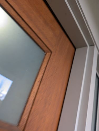

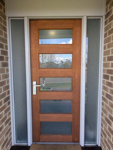

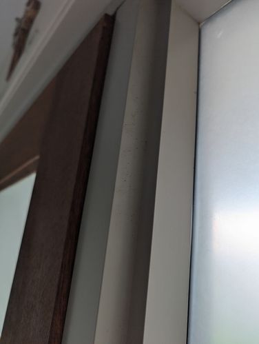

Hi all, how would I fix the top of the door sticking out not sitting flush with the aluminium frame?
Photo is of when door is fully closed.
Any ideas please

Hi @Maxi as @EricL has mentioned it apprears something isn't square (door or frame). I can see the door is glazed so it will be a solid core, which is rare to see warped. Aluminium frames don't warp unless the fixings have changed. How long has the door been like this?
The first thing we need to establish what's out of whack, the door or the frame and then why? Ifs the frame is out we should be able to fix this. But if the door is warped, it can only be replaced.
Standing the door open, use a trusted straight edge like at least a 1200mm level vertically and across and eye-ball its edge. You can also run the level plumb against the front or back face to check what that looks like? Now do similar steps on the frame and note the results.
Once you have that info, get back to us for ideas on next steps. Suppling some additional full front and back photos will help.

Evening @Maxi
Having a few looks at the door I agree with @EricL and @Nailbag's suggestions to move forward.
I do have a question tho ![]()
Is the door a sliding door? You say its in an aluminium frame and the only time I have seen that is for a sliding door.

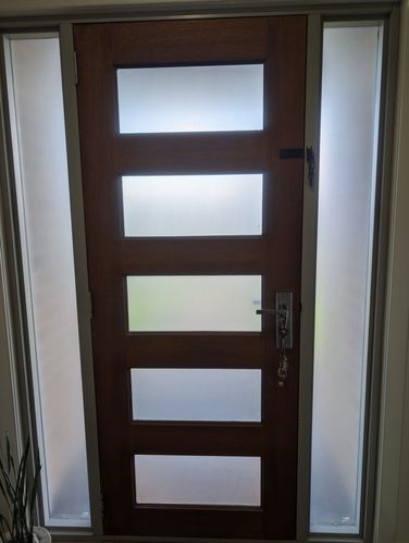

Any chance of an overall photo or two of the door and the whole frame it sits in?
If its a sliding door then maybe a channel has moved or is out of place (depending on if it was flush until recently)
If its a swing door then I will wait for some more pics. I figure if its a swing door that has warped then that glass prob would have have a high chance to crack or break. Mmmm will wait for those pics ![]()

It's a swing door, I'll post more pics of the door once I get home earlier on today.
We'll be keen to hear how you go with that straight edge @Maxi.
If the lower section of the door sits flush with the door jamb and the lock/handle still works, then it's quite peculiar that only the top would stick out like that.
Let us know how you go.

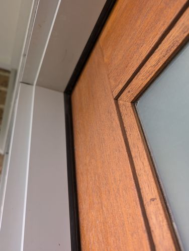

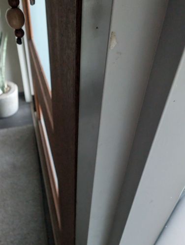

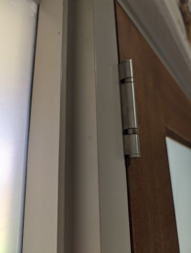

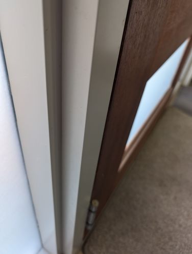

here are some more pics
