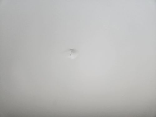

Accidental the wall was elbowed which has made a dent in the wall. Can someone please tell me if this is fixable without a professional. If yes, can someone tell me how. Thanks.

Because the damage is not that big, I suggest using UNi-PRO 500g Multi Purpose Interior Filler - 500g. It comes with an applicator and it's easy to use. Your goal is to fill the dent to the same level as your wall. This will save you from having to do extensive sanding.
Once the filler cures, I suggest sanding the surface smooth with a 240grit sandpaper. Wipe the surface clean and make sure to remove all the sanding dust and debris. Once the area is clean and ready you can paint the surface so that it blends in with the wall.
