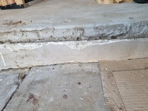

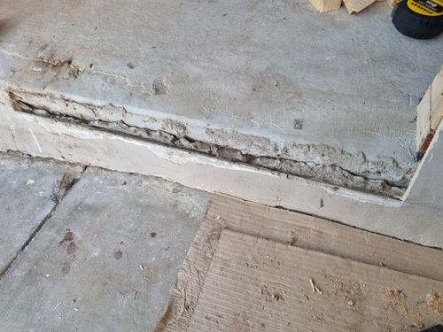

Hey there, I've just removed a doorway and keen to tidy up/fill in the flaky edge of the slab (see photos). What product(s) should I be looking at? Something like this maybe? Will be running decking up to here.

Thank you for your question about fixing the face of a step up in your slab.
Dunlop 5kg Ardit Rapidset Repair Mortar will be good for this application. Start by cleaning the concrete thoroughly with a stiff bristled brush such as this Sabco Bamboo All Purpose Heavy Duty Scrub Brush
Once clean, apply a bond coat of BondCrete, mixing as per the manufacturer's instructions. This will act as a primer, creating better adhesion between the repair mortar and the existing concrete.
Once the bond coat has dried, use a Brick Trowel to apply and shape the mortar to the desired finish.
