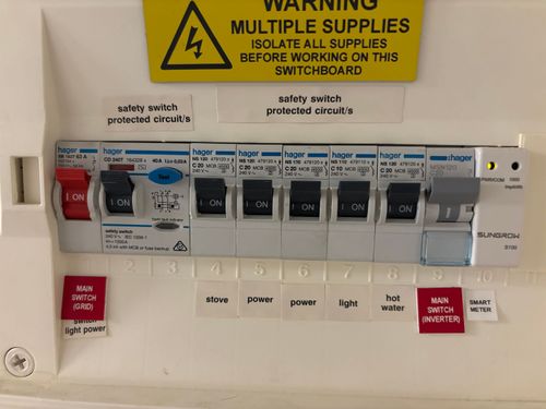

@MitchellMc and @KMc1 unfortunately the maximum demand is something that needs to be assessed by an electrical contractor, there are several different methods to obtain maximum demand on a premesis and it has to be done in accordance to the regulation AS3008 and AS3000.
Talk to the electrical contractor that you are likely to engage to disconnect/reconnect or rewire first up and then go from there.

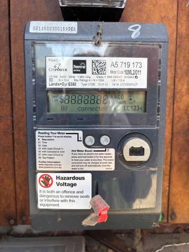

Hello! Can you tell me how I would work this out? Have posted pics of my smart meter and switchboard in my original post if this helps?
My neighbour thinks each apartment has max 32A, with a 40A main breaker switch?
