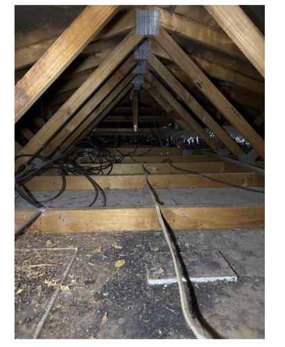

need to enter the roof cavity to install insulation bats and remove/replace excess coax cable points with cat 6 data cabling.
Man hole entry is pretty standard however the house is quite old so the roof is very low to what I’ve seen in newer homes.
Few metres into the cavity the trusses from the garage start intersecting with the rest of the home making a normal crouched approach quite difficult without falling through the drywall.
I’m essentially after some ideas and inspiration if anyone else has had similar problems and how to go around it and make the job a lot easier as I’ll be needing to enter and exit this space a lot over the next few weeks.
(photo attached was taken from manhole during pest and building inspection)

A family friend of ours had the exact same issue where they did not have enough room to manoeuvre inside the roof cavity. They hired professional insulation installers, and they actually removed the edge of the roofing tiles in order to access that low section of the roof. It was an impressive technique, and they finished quite fast. However, I'm not sure if it will work on galvanized roofing. But before installing your insulation, I suggest checking your local council's rules and regulations in regards to installing insulation.

It definitely makes it more challenging with a metal roof and widely spaced trusses. Resting several planks of timber across the trusses will allow you to navigate starting from the furthest point working your way back. It will be a terribly slow process if you tried to bring in all the batts in through the manhole, and then you may not have access to all areas of the roof space due to valleys. So you will need to lift several roofing sheets at stratigic points to drop in the batts as well as position the ones in those far reaching low points. The open sheets will also allow a lot of good working light in. Obviously you need good weather and definitely not on a windy day and with at least one helper.
Thats the process, but whether you should do this yourself due to the obvious safety concerns is another matter. I would recommend getting a few quotes first and then way up affordability vs the challenges of DIY.

When I have run cabling around the roof space I have generally used myself as a "plank" think of a slug spanning several joists. I have wanted to take some flat pieces of timber up into teh cavity to help with the running of things so maybe you could do the same, something light but wide (Ply but depending on the distance spanned between joists maybe pine, I would keep that in mind)
I am not keen on removing tiles/roofing, mainly as I dont have the experience.
I would take my time bring insulation up through the manhole and gradually work from the hardest areas back, leaving the easiest ones todo last. Much like painting a floor. I would also take up some timber dowl or resonable solid timber trip to help extend the length of your hands when setting the insulation in place.
Lastly, Turn off teh power before climbing into teh ceiling space, I mean at teh main circuit breaker for lighting and power. It is just a matter of caution as crawlinga round you dont know what has been done previously and do not know what may be exposed.
I ended up with some bruises from being that plank but thankfully managed to diostribute my weight evenly and no holes into the house

I would also take the opportunity before the batts go in to update any of the lighting and in-ceiling heating and cooling. Once there has been a lot of traffic in the roof space, sort be surprised if the internal ceiling starts to show some stress. That will be your next repair job.
