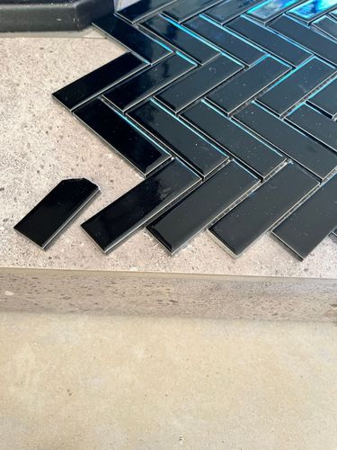

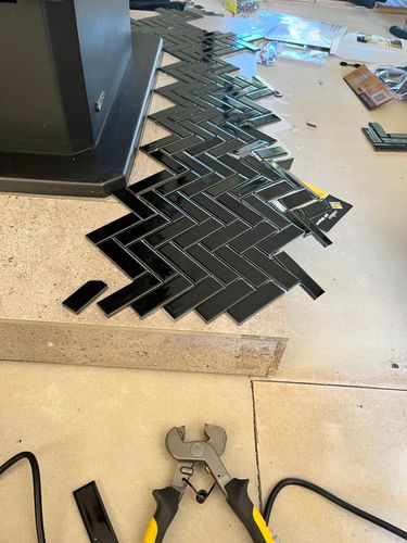

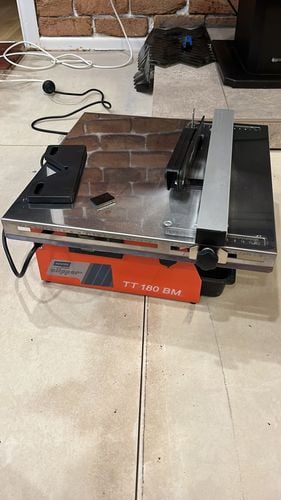

Hi Mitchell! I have run into another issue. I wanted to use these tiles from Bunnings pictured below for the fireplace but I’m finding it very hard to cut using a wet tile saw or even the qep nippers, do you have any suggestions on what I can use to cut these in little triangles that are needed to finish off a herringbone pattern?
Hi @Nonica2605,
The wet tile saw will likely be the best tool for the job. Are you trying to cut the full sheets in a straight line or individually cut the smaller tiles? Ideally, it would be best to leave the tiles in the sheets and make one long straight cut to achieve your flat edge for butting up against the fireplace. Trying to cut the individual tiles on a wet saw would be considered an advanced tiling skill and not something I'd really recommend. Although the diamond blade doesn't have teeth like a timber blade, you'd still be placing your fingers very close to it. Perhaps you might consider doing most of the tiling work and then having a professional cut the remaining tile to fill the voids.
Those nippers will also give you trouble, as they are designed for taking small chunks off tile corners, etc. You'll find it hard to get consistent lines.
If you can provide our helpful members with some details on the difficulties you have been having, I trust they'll have some solutions for you.
