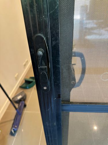

My townhouse has rear garage parking but the back fly screen door is only lockable from the inside. I would like to make it lockable from the outside as well so that I can enter the house from the rear carport rather than having to walk around the block of townhouses to the front door. Any recommendations for Bunnings products that might work with this or would
I be better to go to a door specialist? The glass sliding door has a key lockable set up so it is just the fly screen door that needs changing. Picture of current set up below. Thanks!

Assuming the mounting holes line up and the rebate for the locking mechanism is deep enough you should be able to use this Whitco Leichardt Black Sliding Security Screen Door Lock.
If you can measure your current lock so we can compare it to the below dimensions, we will be able to confirm if it will work for you.
Let me know how you go.
