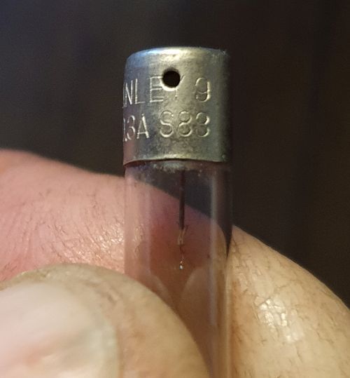

It works, but the illumination 'bulbs' have blown.
Stanley 8V 0.3A
Could I source these?

Probably unlikely..I can't tell what the base fitting is in the photo..
The first thing you would need to check is if there is any voltage where the bulb fits in..If there isn't then not much point in looking for a new bulb..
The other thing is 8V. is an unusual voltage for a bulb..and they probably don't make them anymore..

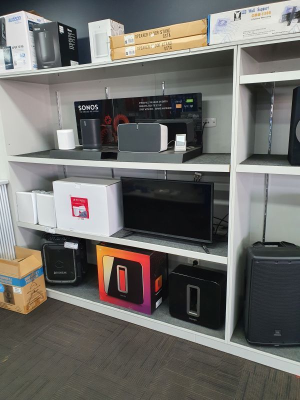

And a sign of the times?
No component systems seen in the store.
Bluetooth speakers only.

You could take it to an electronics repair shop and ask them to change over the existing socket to a mini 9V. socket.
Providing of course that there is still power going to the socket..
That unit would be a gem if you can get it working..

After a bit of searching, I found that the item you can use to replace it with is called an "LED Lamp Vintage Receiver Fuse Type Bulb Replacement AC8V Warm White". If you do a search it should lead you to several places where you can get them. I believe they come in different voltages and amp levels so just keep an eye on that before you commit.
