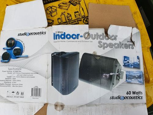

"I suggest transferring them to the front post connectors rather than the surround posts."
I have done that - but there's only room for two speakers?
So my question above was where do I put the other two - based on what the Prof says above, I'm limited. I went with SURROUND L & R as seen above.
Seems to work, but not as loud. However they are different speakers - in fact, they were the last outdoor speakers at the local Bunnings. I believe they're all only available online now?
Cheers
Graeme.
Hi @Noyade
If you've already got the front speakers occupied your only choice is to use the surround posts. The adjustment setup for the surround speakers is located on pages 42 and 43 of the manual. I suggest choosing large surround speakers and adjusting the volume accordingly if possible. The @Prof was right it was called a YPAO setup but I suggest doing it manually as you don't have the adjusting microphone that comes with the unit.
Noyade...If you want to hook up just four main speakers and no surrounds, you can connect all four speakers to those two terminals..
Just make sure you connect the two positives to the positive terminal and the negatives to the negative terminal..
Making connections in this way will halve the impedance of the speakers and that will increase the sound level..
Thanks Prof and Eric.
"you can connect all four speakers to those two terminals.."
Thank you for that! I'll give it a go!
EDIT: 1535 hrs > It works a treat! Thanks very much! 😁👍
