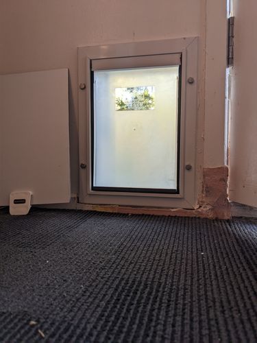

I want to put a door for our cat in the back wall of our house. It's plasterboard on the inside, overlapping wood planks on the outside, with about 120mm between inside and outside. Can anyone recommend a pet door and a method of doing this? Most of the commercially available ones seem to be for much thinner walls/doors, with the inside and outside parts meant to attach to each other in some way.

These are for you, @MitchellMc 😁. A bit rough, but functional (if the cat would just learn to use it!).

Hello @Toby1
Thank you very much for posting those updates on your cat door. That assembly came out great, I'm sure at some point the cat will realize that they can use it to go in and out. I suggest tempting them with their favourite snack and seeing if they'll push through the flap to get to the other side.
Again, thank you very much for sharing your cat door project.
