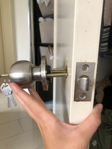

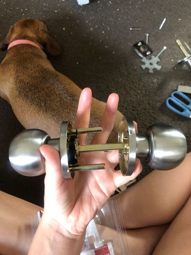

I bought the entrance lock from ikonic, my door is 35mm. The lock says it is 35-55mm and is currently set at 55mm. How do i adjust it?

The default configuration of the door knob is 35mm, I propose taking the doorknobs apart and making sure that the locking nib or button is on the open position. The axel of the doorknob should technically slide into the other door handle all the way in. I propose twisting and turning the side without the axel to see if you can line up the axel pin allowing it to slide all the way in. Please give it another try and let us know if you have any success.
Here is a handy step-by-step guide: How to change a door knob.
