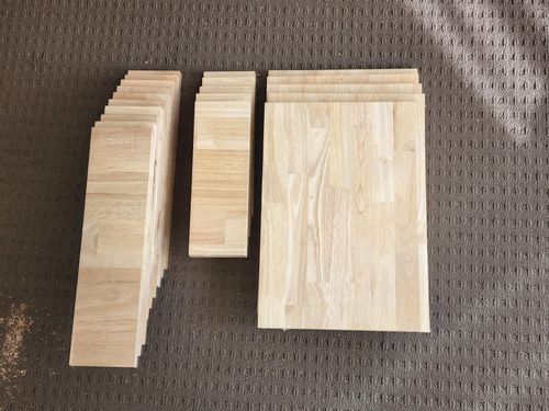

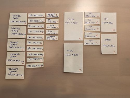

I cut out 10:1 scale model of the various sized pieces required in order to maximize the use of the available panel sizes and cutting requirements.
Once all the dimensions and cuts on the panels were identified, it was off to Bunnings to get everything and get the panels cut to size.

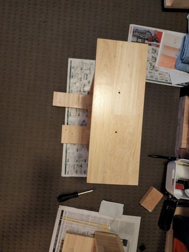

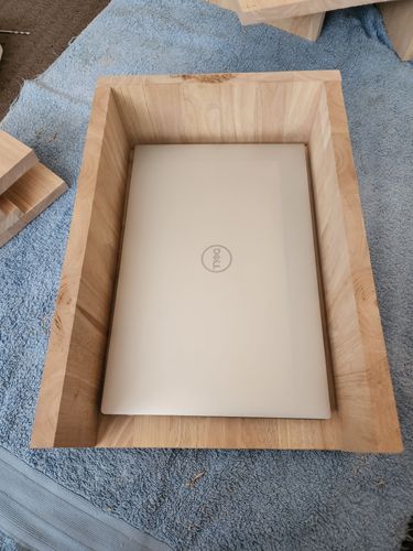

Started off with making the drawers (without the front face) first, as per the above dimensions. Used long screws to screw the 3 sides onto the drawer base. Size check with a 15.6" laptop for reference :-

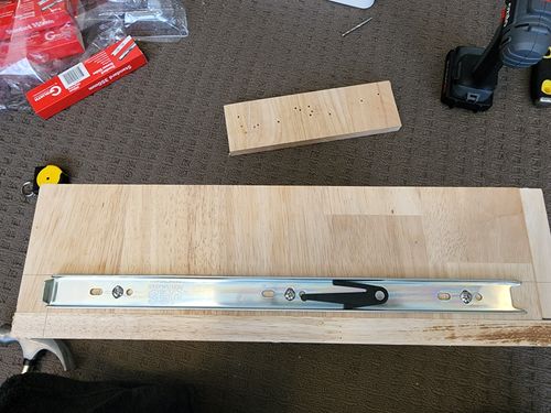

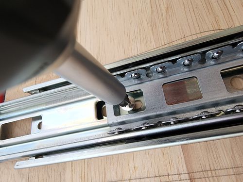

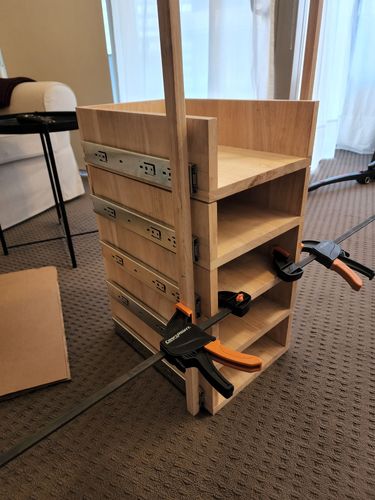

Mounting the drawer slides was a bit tricky. I mounted the drawer slides slightly below the centerline, vertically centred. This would allow the slides to run smoothly without fouling the drawers below.

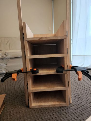

Once, all the drawers were built and slides fixed, I used the off cut pieces to measure and fix the dimensions of the cabinet.

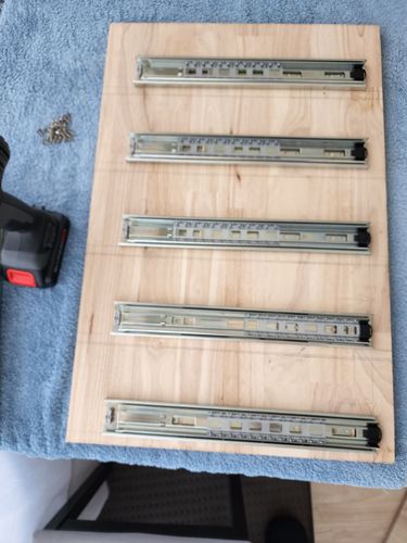

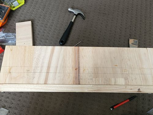

Lot of lines and markings to mount the drawer slides

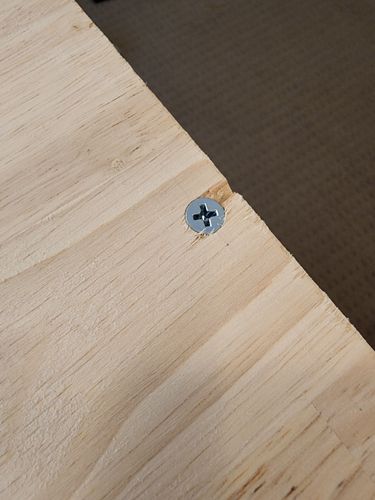

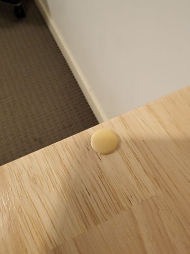

I discovered that rubber wood is a medium soft (or hard?) wood that splinters easily, so had to lower the drill speed. Had a couple of minor splinters like this, which were patched up with wood putty.

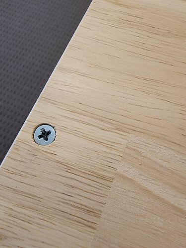

Counter sunk all screw holes with an 8mm drill bit and then pilot holes of 3.5mm were drilled for 10G screws.

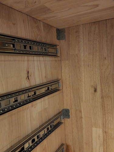

In addition to the screws, I used Carinya 25 x 25 x 40 x 1mm Galvanised Angle Bracket - 8 Pack on the inside of the cabinet for reinforcement.

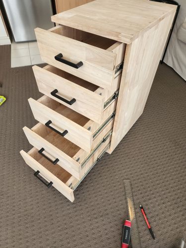

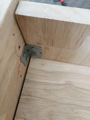

Using the corner brackets on the insides of the drawers to mount the drawer face was a bad idea though - not enough space to get the drill driver to drive the screws in; and also impinges on internal drawer space. Switched to mounting the corner brackets on the outer side of the drawer was so much easier. All the excess drilling holes were later patched up with wood putty.

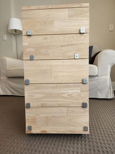

I used the Carinya 25 x 25 x 20 x 1mm Galvanised Angle Bracket - 20 Pack as spacers to determine the mounting positions of the drawer faces.

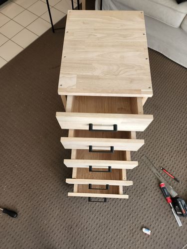

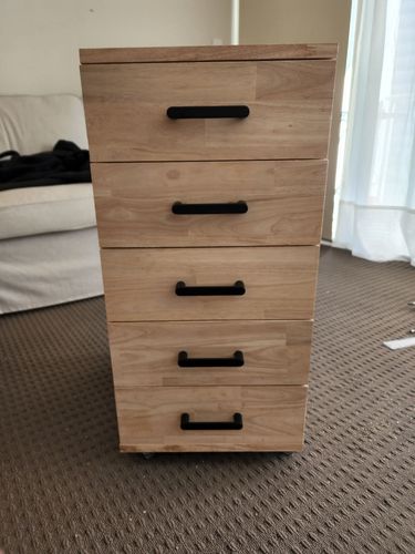

Once drawer faces were mounted to the drawers, a quick check (and adjustment) of the slides to ensure each drawer moves smoothly and doesn't foul with the other drawers. Handles were then attached to the drawer faces.

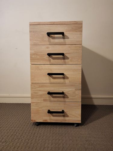

All the math, planning, adjustments and accurate-to-the-millimeter calculations later (:D), all drawers move smoothly and close flush

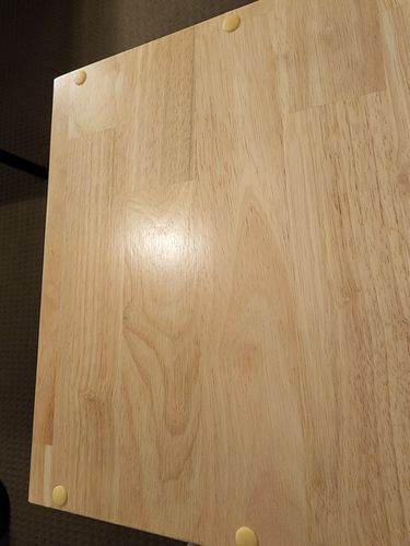

Removed the drawers, slides and handles and filled gaps/excess drilling holes with Timbermate 250g Pine Wood Filler and then sandpapered all surfaces with 80 grit, then 120 grit and finally 240 grit sandpapers to get a smooth, almost silky finish.
I decided to do a clear coat instead of a colour match, so used Cabot's 1L Satin Water Based Cabothane Clear Polyurethane Timber Varnish - recommended was 3 coats, but I ended up putting 5 coats because I wanted to finish off the can.

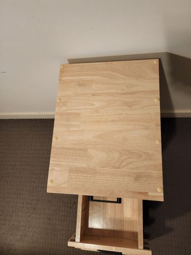

I used screw caps to cover the screw heads. Finally, mounted 5 Move It 30mm 20kg Grey Swivel Plate Castor - 2 Pack wheels on the bottom of the cabinet.

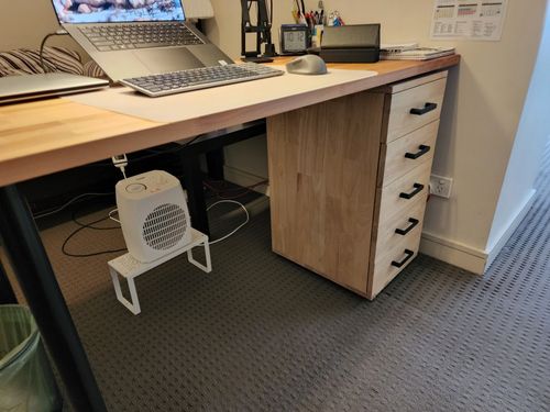

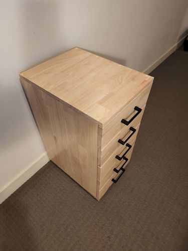

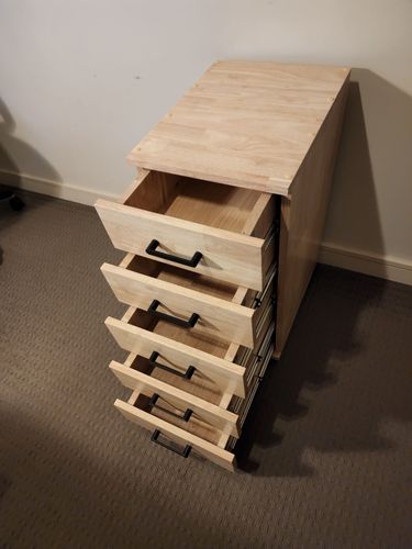

All done
The Cabbots Satin Clear coat gives an nice subtle sheen :-
Gaps inside were filled with wood putty.
That's some exception craftmanship @vr-syd. I'm very impressed with the amount of effort you've gone to and the overall result you've achieved. Also, I'm a massive fan of your chosen handles, as they offset the warm timber nicely.
I've passed on your feedback about Harrisons' assistance to the team leaders at Bunnings Pymble. They are thrilled to know of the service you received.
Many thanks for adding so much information to your post, as it assists any of our members who want to replicate your project.
Great work.
Well done @vr_syd. They look terrific. Thanks also for sharing such detail so other community members can replicate your handiwork. I'm sure many will be inspired by what you have achieved.
Now that does look nice! Solid.
Heavy?
Well done.
Thanks for the kind words @MitchellMc . I do like the handles too - initially I thought they might be a bit too big for the drawer face, but turned out just fine
Thanks @Jason . Inspired to do this and so many other projects from the posts by other members here
Thanks @Noyade
Yes, it is quite heavy and very solid! Weighs around 44 kgs - unladen. Has 5x castor wheels that can take 20kg each, so I'm reasonably confident this little thing can carry a fair bit
