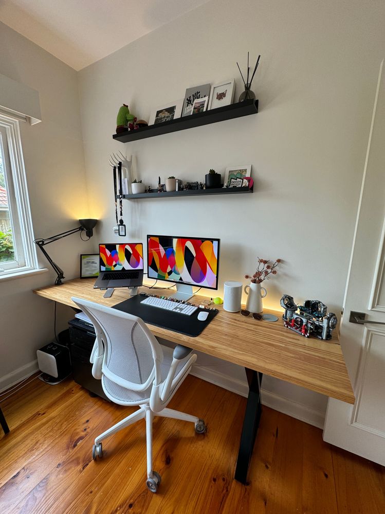

Hey Workshop community, it's been a while since I completed this project. Some updated photos attached.
Updates include some new IT hardware, computer chair and some shelfs from IKEA for displaying little trinkets and other special items.

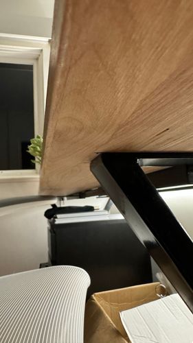

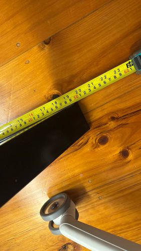

Re: Home office desk
Hey @KristyM1 ,
Mystery solved. The legs I purchased were 500mm deep, not 700mm deep. Looks like a mix up in barcodes when I purchased the item.
I've had a look on the Bunnings website, and I can't find a product currently available that matches what I have. It looks like their range is consistently 700mm deep.
If you do purchase the 700mm deep legs, angle them at 45° and the table will be rock solid. Can't wait to see your finished desk!
