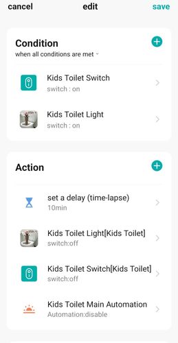

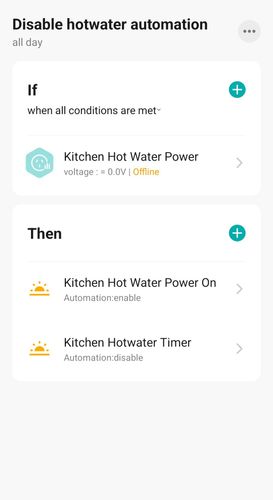

Re: Grid Connect, Tips, Tricks and Help - Please post and share

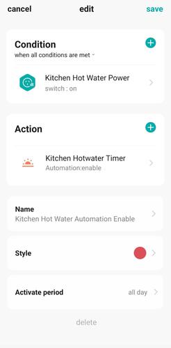

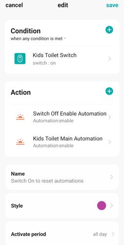

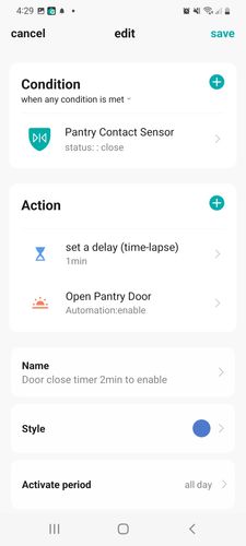

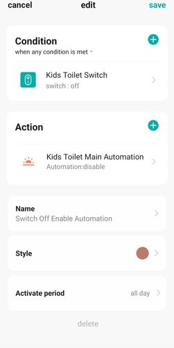

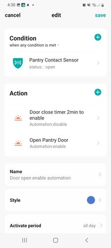

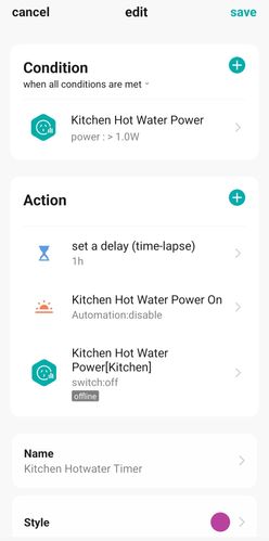

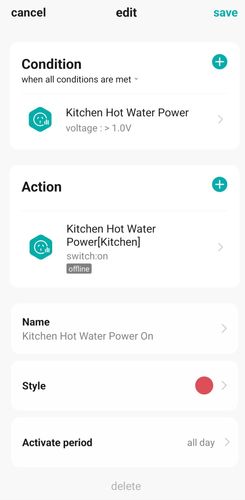

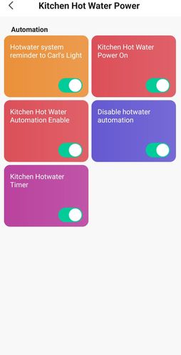

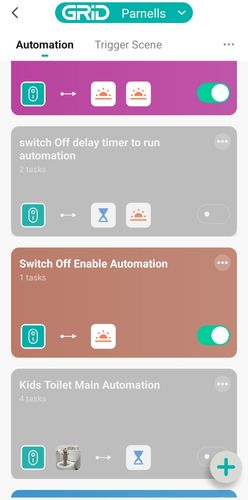

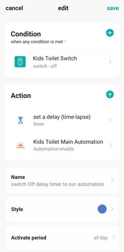

I have had to make the following changes due to I was getting an error notification through still this is because when power was turned off to the power plug it freezes every output and nothing can be triggered from that point so adding a delay timer off the initial input that turns the automation off prior to 1hr and then another scene that is triggered off the same variable that turns back on the automation after 1hr let's the automation work but stops the error message if you turn off power prior to 1hr and then the automation is turned back ready for next use.

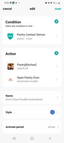

Our kitchen is fairly dark and we were considering a solar powered alternate skylight for around $250 but instead I removed a 4 way bar light installed 2 extra downlights as smart lights and swapped one over to smart and positioned them in the dark spots, I then installed one of the Bluetooth motion detectors so that I can control when the lights come on but also how they react to the light sensor and also scheduled events during the day.
During the day the colour is set to DayLight up until 20.30 then it switches to Warm White and dims down for the nights, set times in the morning the lights are on full time so the sensor does not kick in and out and also at peak times at night, every other time it's sensor with on for 10min then another automation if no movement for 2min turn off.

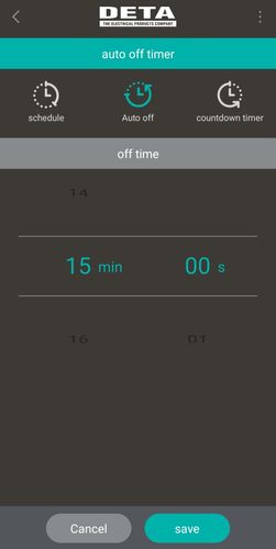

Arlec Grid Connect GU10 Bulbs - removal of timer function.
Well Arlec has gone and done it again in their latest update and removed another feature that in my opinion was beneficial over having to carry out another method or 2 step automation and I will explain why below.

So the timer function over the delay function with a motion detector works much better as it doesn't flash off then on again at the end of the desired time for the reason you don't need to put the globes or lights "Off" in the "If" statement of the argument like below.
As you can see there is no "Off" function at all the end of timer knows to switch off if no other motion is detected.
With a delay function you require a "Off" statement in the "IF" argument and also after the delay so after the delay has timed out it will turn off for around 2 sec then the motion will retrigger.

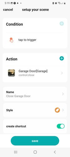

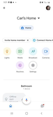

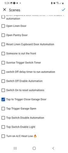

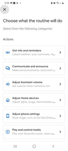

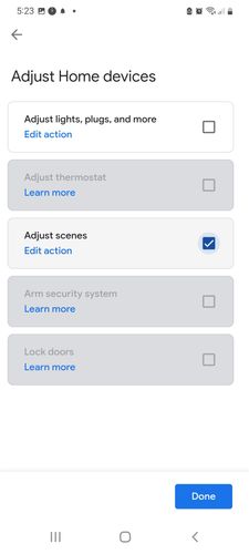

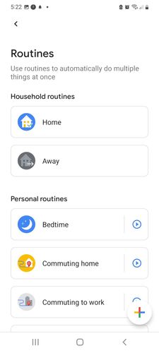

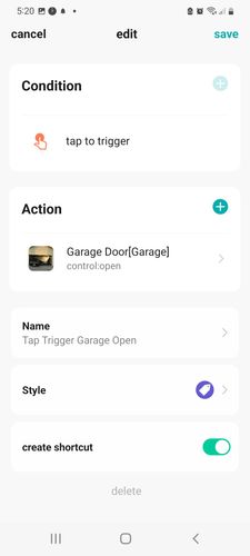

Thank you @CSParnell this has come very useful. Question when I trigger to open the garage door manually via the google home app under devices it still asks for a pin even though I have turned it off for voice command within the Grid Connect app, any ideas?
CSParnell
Hey @sam00,

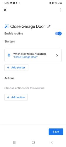

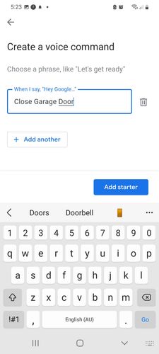

I would say its to do with the scripting behind the connection between the 2 apps where when there is voice command through Google or Alexa it requires a password but unselected the password still remains so it is looking for it.
I did work out a work around for avoiding a password through google voice at once stage using triggers within Grid Connect to open and close the garage door and then assigning voice commands to those triggers in Google to activate those triggers which bypassed the pin number.
Other option is simply save the Grid Connect Garage Door Opener Icon to your home page of your phone for quick access and just use that no pin required.
