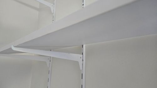

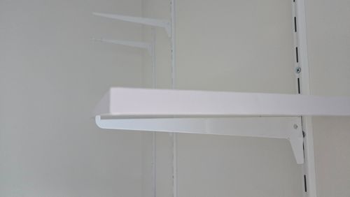

I might be doing something wrongly, but it seems to me that the shelf cannot sit flush on the single S-Track brackets? Either the board is too wide or the S-Track bracket is not wide enough.
What can I do?

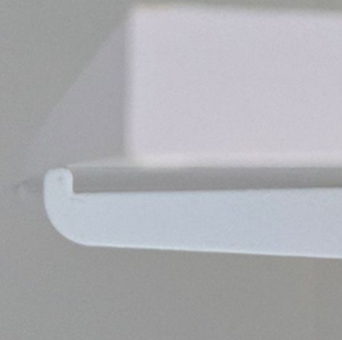

Flexistorage has previously recommended inserting the front of the shelf first and then lowering the back in. They've found that putting the back in first and then lowering the front causes the tongue on the front end of the bracket arm to come into contact with the front edge of the shelf.

As you can see they don't fit and i will only return it all if you want to send someone to repair the wall

Not familiar with the product - are the shelves sheet metal or wood?
If they're melamine coated wood - clamp them into position?
The fit seems very close...
One mm?

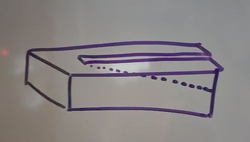

With a panel saw cut a taper in a small block of wood and fit into position under the shelf at this end.
Another block above.
Then squeeze with a clamp.
That steel 'lip' will bite into the melomine and make a secure grip - better than being loose on the shelf.

yes I have tried their recommendation
As you can see it does not help
You push or hit that down with a rubber mallet it damages the shelf and flies off the wall
As per other people's concerns and pictures
It seems poor quality product and reasonable solution is to just provide shelves slightly less depth that will fit, this is what I have been asking for assistance with
