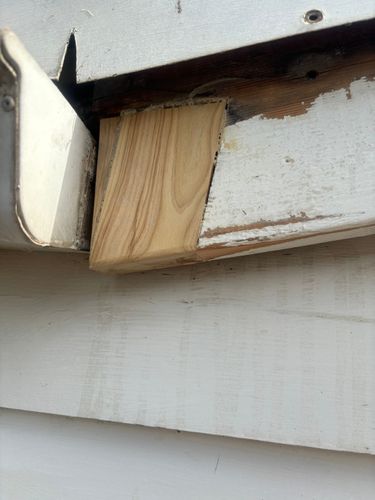

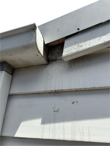

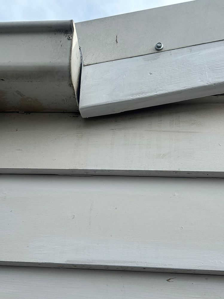

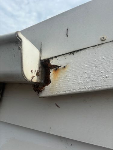

Rotted  fascia
 Cut out damaged area

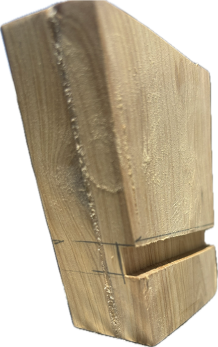

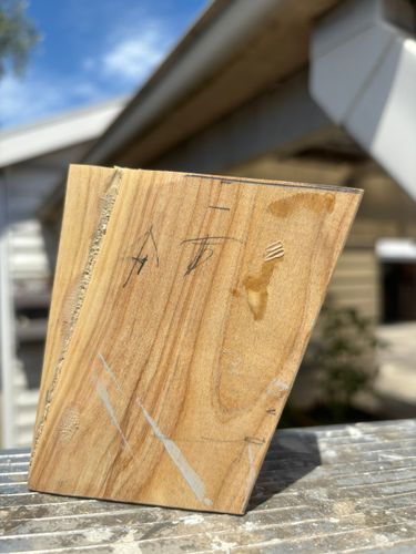

Fabricate and glue up new replacement cypress pine timber
Router a slot for water run off to match existing fascia board
When glue has dried, sand and shape new piece of timber to fit in place, then glue and clamp in place
 Now it’s ready to undercoat and finish paint
Now for the rest of the house.

What a great solution @JoeAzza. That's surely saved you a great deal of time and effort to replace the whole board.
I suspect that given the proximity to the gutter, there's potentially been an ongoing leak, or the gutter is not graded sufficiently, and this has been an overflow point. That water has managed to get into the timber beam, and decay has set in. It might be a bit difficult now, but painting the end of the timber would help prevent water ingress.
I'd try to block off and fill up the end of the gutter with water to see if there is a leak letting water migrate into the end of the timber. Resolving leaks in the gutter would go a long way to preserving the timber.
Re: Fascia board repair
Thank you @MitchellMc @for the advice,  I did notice that the original board was cut to fit tight against the gutter wall, so I thought that may have been the cause, not allowing water to escape, I made the new piece a bit shorter so it wouldn’t touch the gutter.

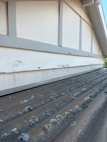

i will try to get some paint on the end of the board, hopefully out will last for a long time. Wood rot is my biggest issue, mostly on weatherboards.
here is a photo of a weatherboard that will need repair or replacing.
