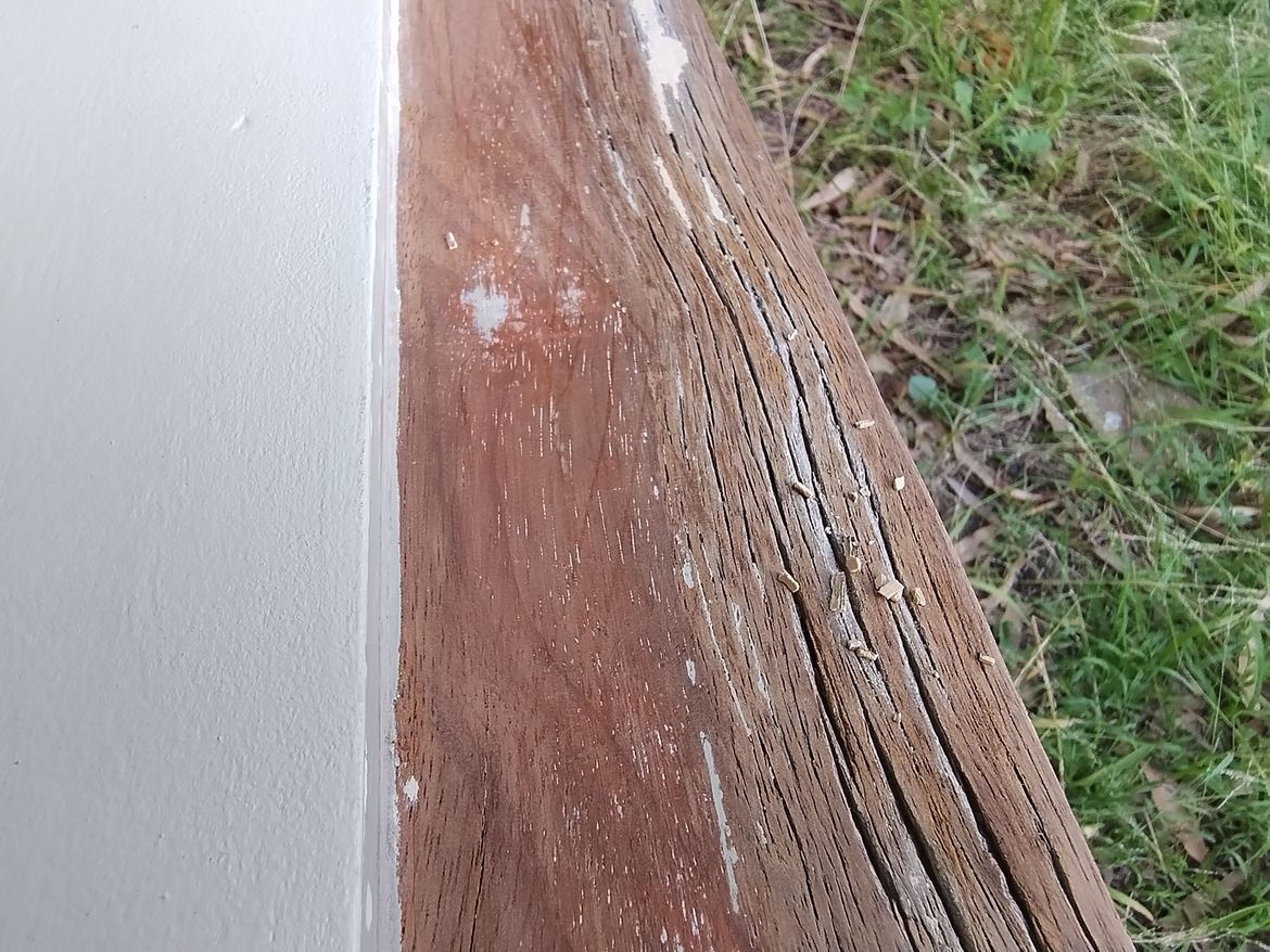

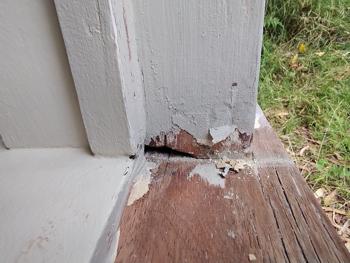

I have an east-facing awning window and its sill needs a good level of attention. My goal is to restore it without having to replace it(full or partial)
Please review the photos.

I have previously tried to repair the same section using builders bog & low sheen Weathershield and ended up with paint chipping off (Some of the photos show this)
Do you think this happened because I skipped the process to remove rotten wood & harden its surface?
Secondly, is it still advisable to fill the groove with the bog only after hardening the surface? I think I have already sanded enough.
I realise that I may need to trim off the bottom of the jamb/sash using the multi-tool, chisel, etc and refill the space with filler, etc.

It sounds like you have the method down pat. It's a bit hard to tell why you previous repair has failed. I suspect it was likely due to the window scrubbing on the repaired area when opening and closing. I can't see any other reason why the Builder's Bog would be chipped out like that. Ensure there is enough room, at least a few millimetres. Trimming/sanding the edge of the window frame might be needed to establish this room.
Weathershield is a softish paint whereas an enamel is much stronger.
I would suggest filling areas after you have hardened the timber.

I apologise for omitting the details. Those chipped-off bog patches (So it's not the entire sill surface) were forming a bubble (Before I scraped them off).
So, I think it is safe to assume they did not adhere to the surface due to poor surface prep. Hopefully, the extended sanding & wood hardening will overcome this issue.
Also, it's great to know that an enamel is stronger, so I am convinced the new approach will be worth the effort.
