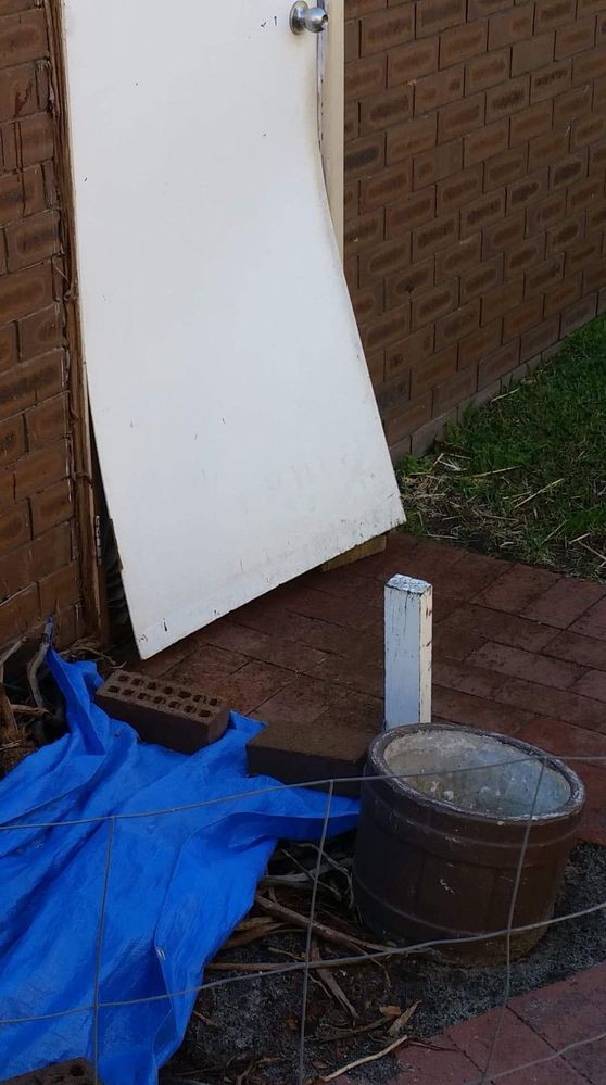

Hi all - I'm looking for a guide to replacing an exterior door on my brick shed/garage.
The old one is an internal door installed by the last owner (a dodgy builder!). No surprise that the weather has deteriorated the door to the point that it is disintegrating. Not to mention the adverse effect of the monstera roots, the monstera that refuses to die!
I'll probably have to replace the door surround as well and would consider using steel door frame.

Make sure the door is a Solid Exterior Door
Also consider a split metal frame installation
