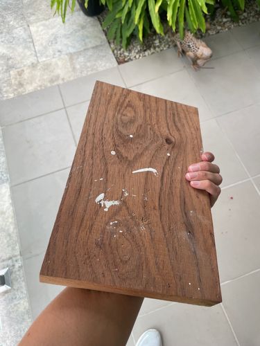

1/10Firstly I found a piece of scrap wood and got everything out that I needed.
Tiles
Adhesive
Adhesive applicator/scraper
Grout
Tape
Sponge
Bucket of water

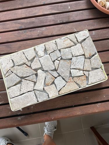

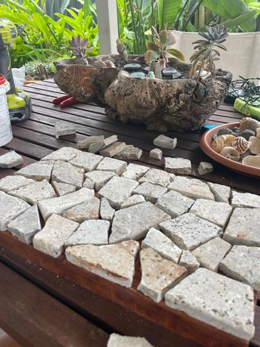

Step 2

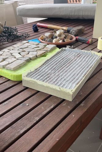

2/10I then got to work setting the tile pieces down in a pattern I was happy with. I broke a few pieces up using a hammer to create smaller tiles when needed.
Step 3

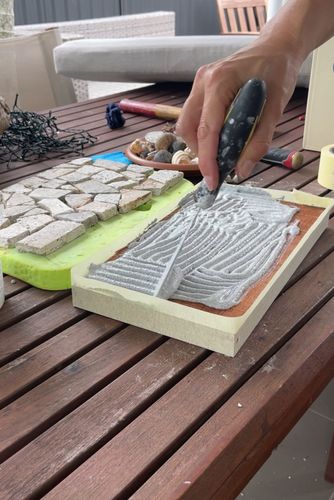

3/10When I was happy with the pattern, I transferred them off the board so that I could apply the adhesive. I taped around the edge of the board to hold any loose adhesive in place.
Then using the adhesive scraper, I applied the adhesive and scored lines down the centre like this.

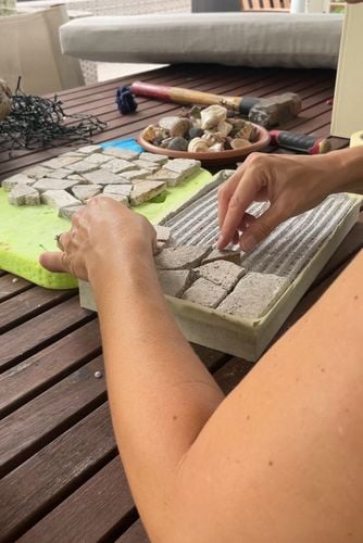

5/10Then I placed each tile back on the board. This is so satisfying to do!
Step 6
6/10Once all the pieces were in place. I left it to dry for 24 hours.

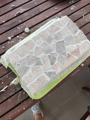

Step 7
7/10After the adhesive had set, it was time to grout.
Once mixed with water, the grout is a thick paste.
I applied using my gloves hands and pushed into each crevice.
I then used a damp sponge to smooth it out and remove the excess

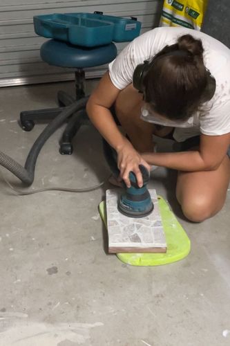

8/10I then left it to dry overnight.
the following day I used an orbital sander with fine grit sandpaper to smooth off any rough edges and blend the grout into the timber.

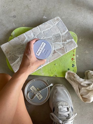

Step 9

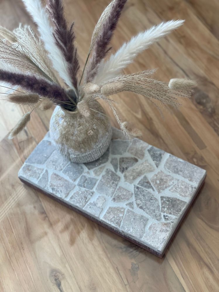

9/10I then waxed the entire piece using white wax. This sealed the grout and tile and makes it easier to clean.

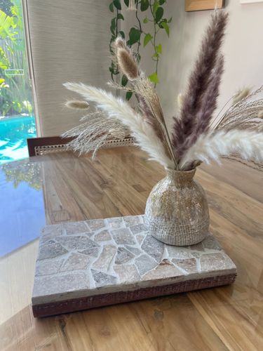

Step 10
10/10 
And then I set this in the middle of my dining table. It makes a nice setting for flowers, candles, picture frames, or could be used to serve a bowl of chips and dip!
I love this travertine tile, and love how it ties in with my outdoor area tiles.
