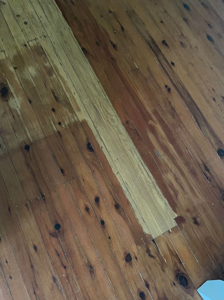

Hey all,
My house has cypress pine floorboards that have seen better days - Pic attached. The floor itself looks in pretty decent shape, few little fixes here and there.
I was thinking about going for a natural look & was wondering if anyone can help with how I would finish the floors once they're sanded down. Would prefer a matte type finish! Floorboards are different colours at the mo, looks like a wall was demolished at some point and a different type of stain/finish was used.
Also, I live in Darwin, the humidity is quite high, just incase that affects the products used/finishes.
Thanks!
Re: How to restore Cypress Pine floorboards?
Hi @rochester,
You might like to check out this discussion: How can I fix these orange Cypress Pine floors? @ezzie, after some hiccups, managed to achieve an amazing natural and lighter finish on their Cypress Pine floorboards.
If you are after a natural look, I suggest going with Cabot's 4L Water Based Matt CFP Floor. It won't dramatically change the natural colour of the sanded timber, is non-yellowing and will give that matt finish you're looking for.
I don't have any restrictions on the humidity requirements; it's just that humid conditions will require a longer dry time. It's still likely best to dry applying it on a day when humidity levels are not extreme.
Here are a couple of helpful step-by-step guides: How to sand timber floors and How to seal timber floors.
