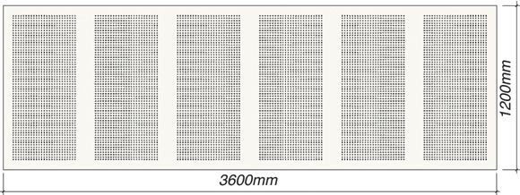

Re: Cutting fibre cement board
That the look you are going for?
Upcut spiral router bit for 12.7mm and under will leave a clean bottom.
Forstner bit for larger holes, not the saw tooth ones as they are more like a holesaw, will leave a vee point in the bottom of the hole.
Problem will be dust, I would stick to minimum holes and cutting.
