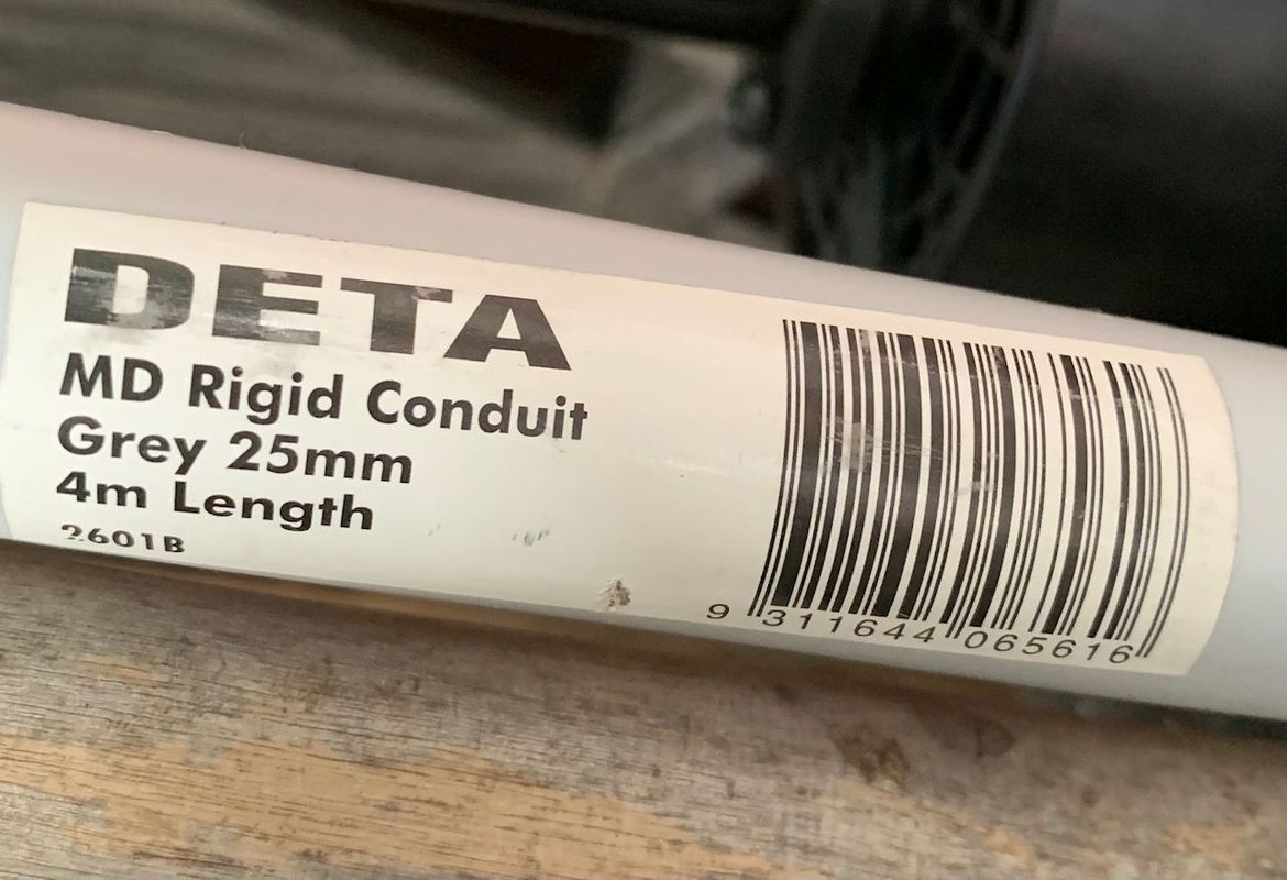

I have installed a grey general purpose conduit (it is not labeled 'electrical'; just DETA MD Rigid Conduit Grey 25mm

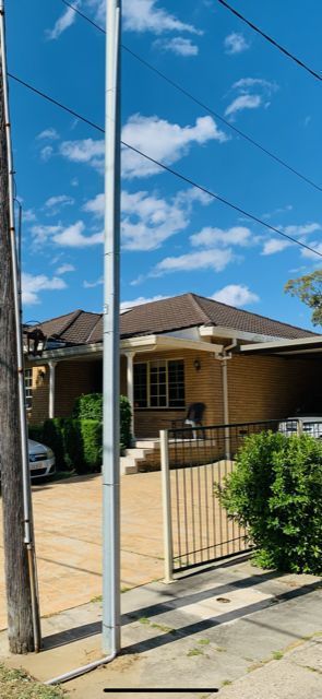

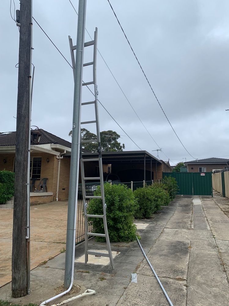

) bought from Bunnings for connection with the NBN conduit in my street, as I had to install a conduit that connects with the NBN conduit in the street to my property before an NBN contractor runs NBN cabling to my property. But the NBN contractor who came told me that I had to use a white communications conduit for the NBN cable. The conduit is half buried and the rest up my private pole.
I did google search but all the posts mention grey electrical conduit and white communications conduit but no posts ever mention a grey general purpose conduit replacing the white communications conduit. Many thanks, Eric. And I look forward to hearing from you.

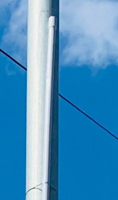

Thank you Jason. I just replied to Eric with more details. This grey general purpose conduit bought from Bunnings is labelled DETA MD Rigid Conduit Grey 25mm. I intend to use it for NBN cabling. A small part of it is connected to the NBN conduit buried and most of it is up my private pole. Please refer to images. Kind regards

Thank you so much for the photo updates. I recommend exchanging your current conduit for a DETA 20mm Internal Rigid Communications Conduit. If you're linking this up with an existing conduit make sure to double-check the size before purchasing it. Size adapters are available in the store if you need to shift from one size to the other. In this manner, you comply with the rules and there will be no confusion as to what is going through that pipe.

Thanks for your reply, which is actually what I had expected. So yesterday I already bought two communications conduits from Bunnings and installed them.
