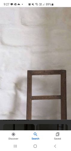

If I were to fill mortar lines with mortar and apply 2-3 thin coats of lime plaster slurry/putty, would this adhere to the brick surface? I'm assuming a cement render or sand mixed with lime or even a clay is used for a base to even out wall etc and act as a base for the top coat to adhere to? I know Lime plaster is usually applied in 3 coats- 10mm base, 10mm float and 4mm top with each 10mm taking atleast 10dqys to dry but I was wondering if I did 2x 4mm top coats would the brick be enough of a base? Also avoiding to scratch the surface of 1st 4mm coat? I've added picture of what I'm wanting to achieve. I'm wanting a really soft finish. I know bagging with mortar will be a heck of alot easier but I don't want that rough render feel.
Re: Plaster Over Brick
Ah! The Mediterranean look @kj2801. Love it!
It's hard to give you a definitive answer unless we use a specific product and follow their recommendations. It might be a bit of a trial-and-error situation.
Personally, I'd build up coats of Gyprock CSR 20kg Hardwall Plaster using a brush. If you get any roughness, you can also sand the plaster for a smoother finish. The plaster will be a much finer mix than a render.

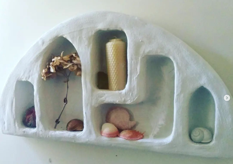

On a side note, I made this hanging wall nook out of cardboard covered in grout (similar texture to render with full-sized sand particles). A layer of plaster over it would really smooth it out.
Oh, I'm extra excited about this project now!
