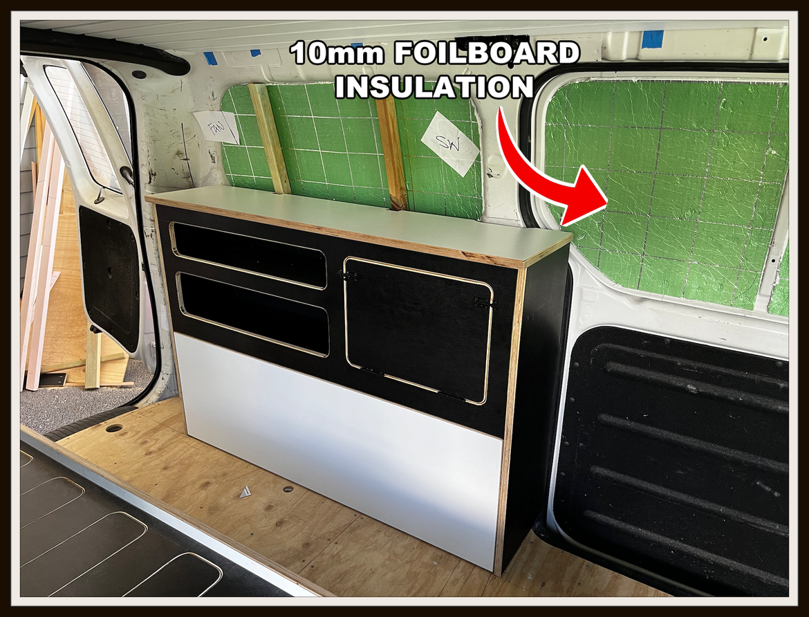

10mm Foilboard for insulation.
https://www.bunnings.com.au/foilboard-10mm-x-2400mm-x-1200mm-standard-10-insulation-10-x-2400-x-1200...

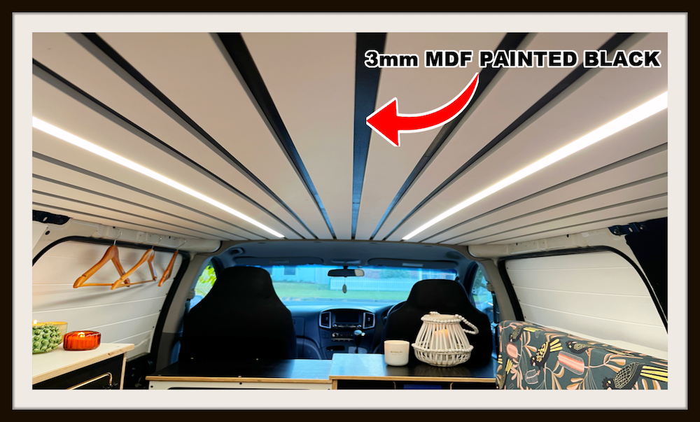

Ceiling lining: 3mm MDF

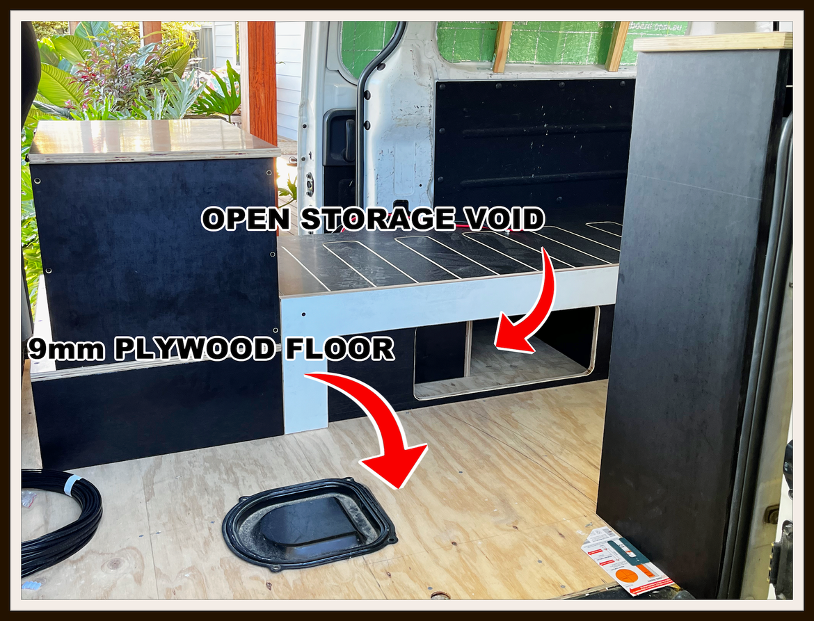

Flooring: 9mm Plywood.

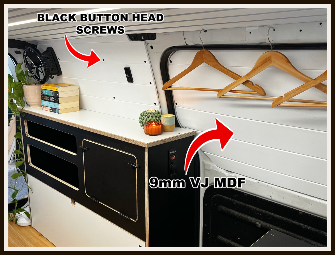

Wall Cladding: 9mm Easy VJ MDF
https://www.bunnings.com.au/easycraft-9-x-2400-x-1200mm-easyvj100-primed-wet-area-interior-wall-lini...

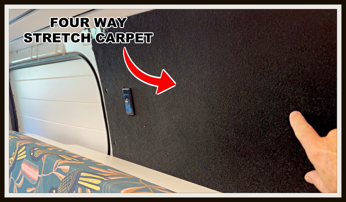

Four Way Stretch Carpet. From Autobarn

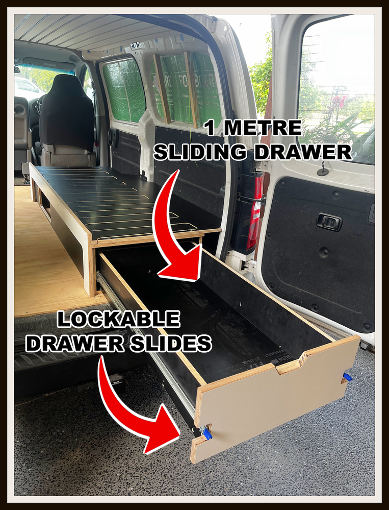

Goliath 1 metre Lockable Drawer Slides
https://www.bunnings.com.au/goliath-1000mm-heavy-duty-lockable-drawer-slide-pair_p4021067
Goliath 600mm Lockable Drawer Slides
https://www.bunnings.com.au/goliath-600mm-heavy-duty-lockable-drawer-slide-pair_p4021063

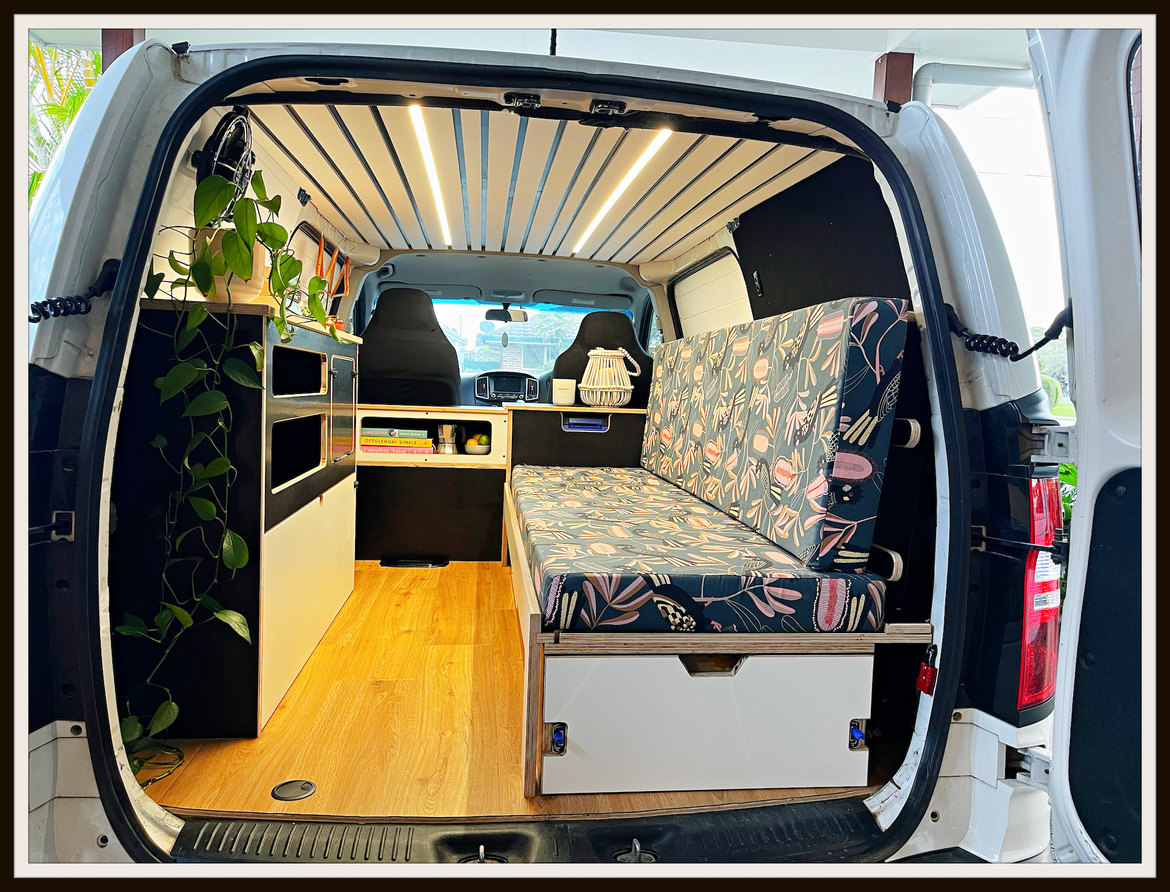

Couple of photos of the finished project!

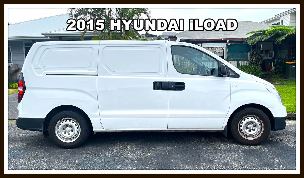

Hyundai 2015 iLoad
The LED lights are one of the features of the van which helps to highlight the slatted ceiling.

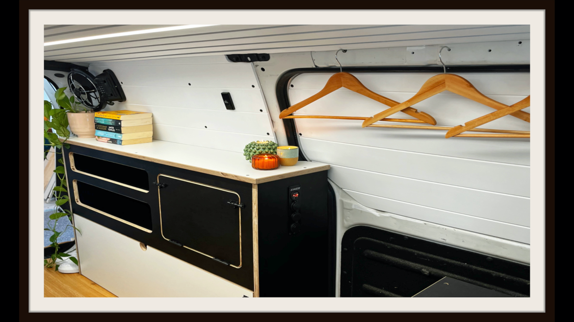

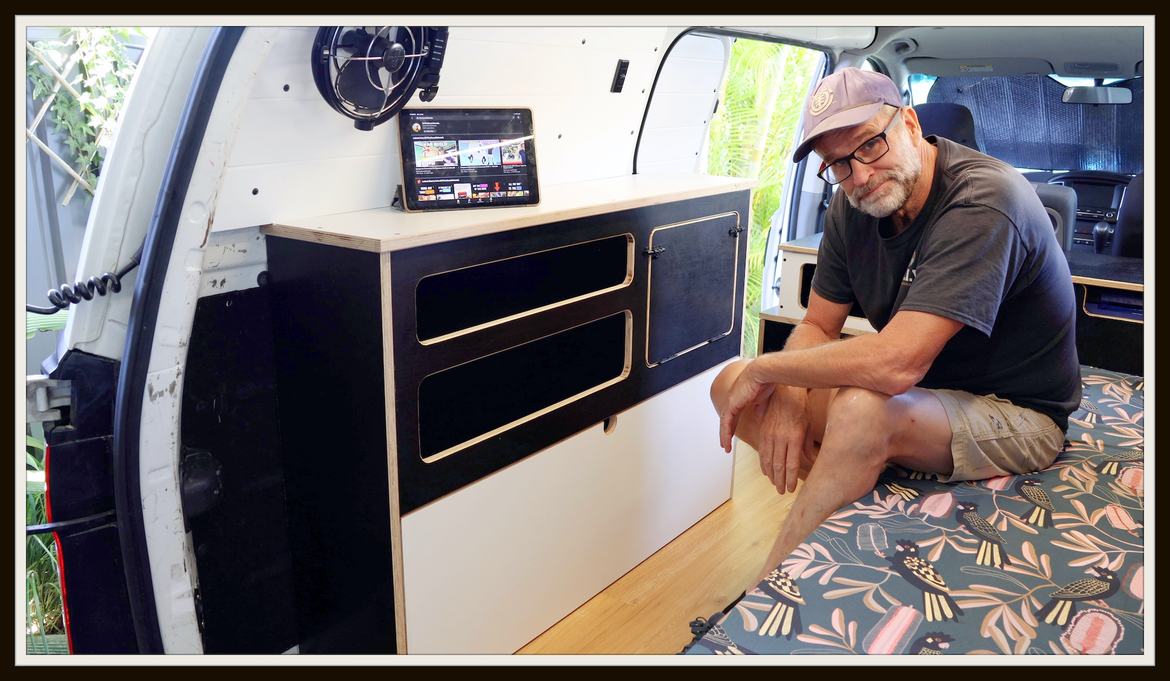

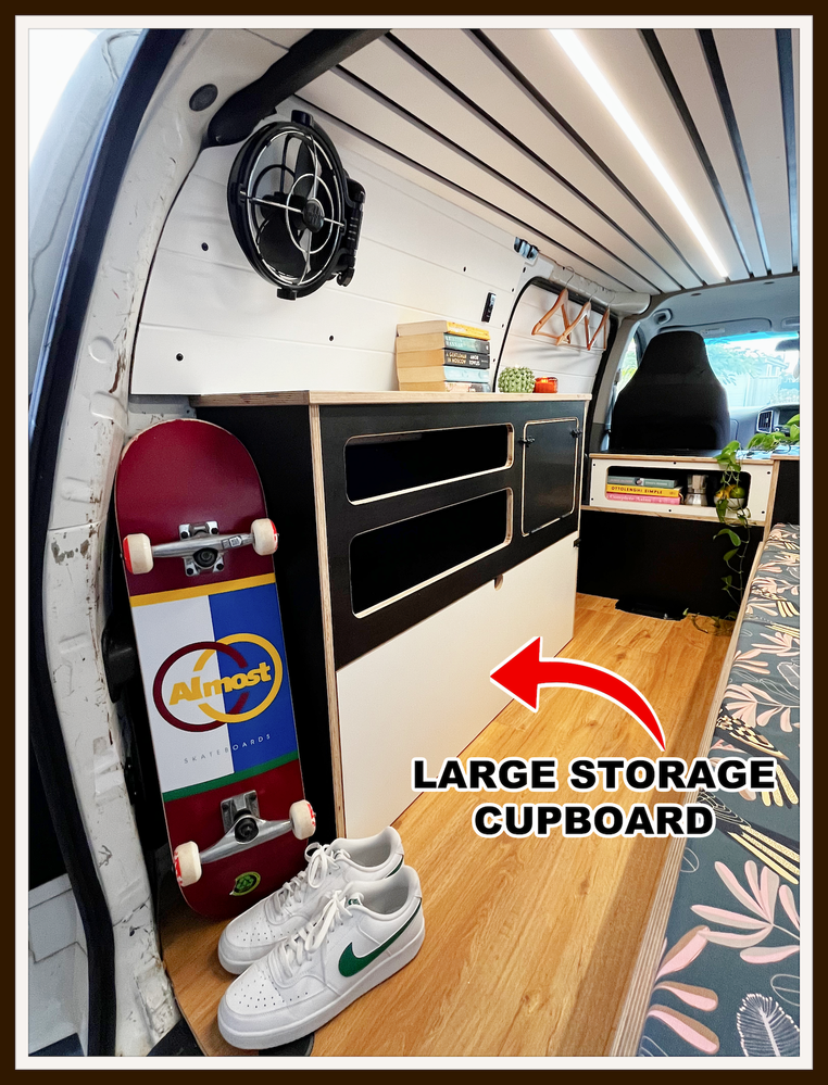

Plenty of storage in the wall cabinet and the natural holes in the vans side panel make a convenient place to hang some clothes hangers.
Two toned cabinetry makes the decor pop!

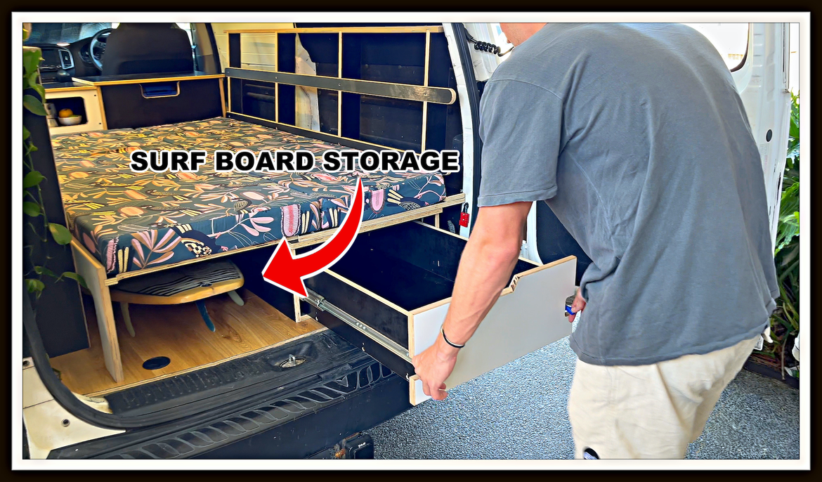

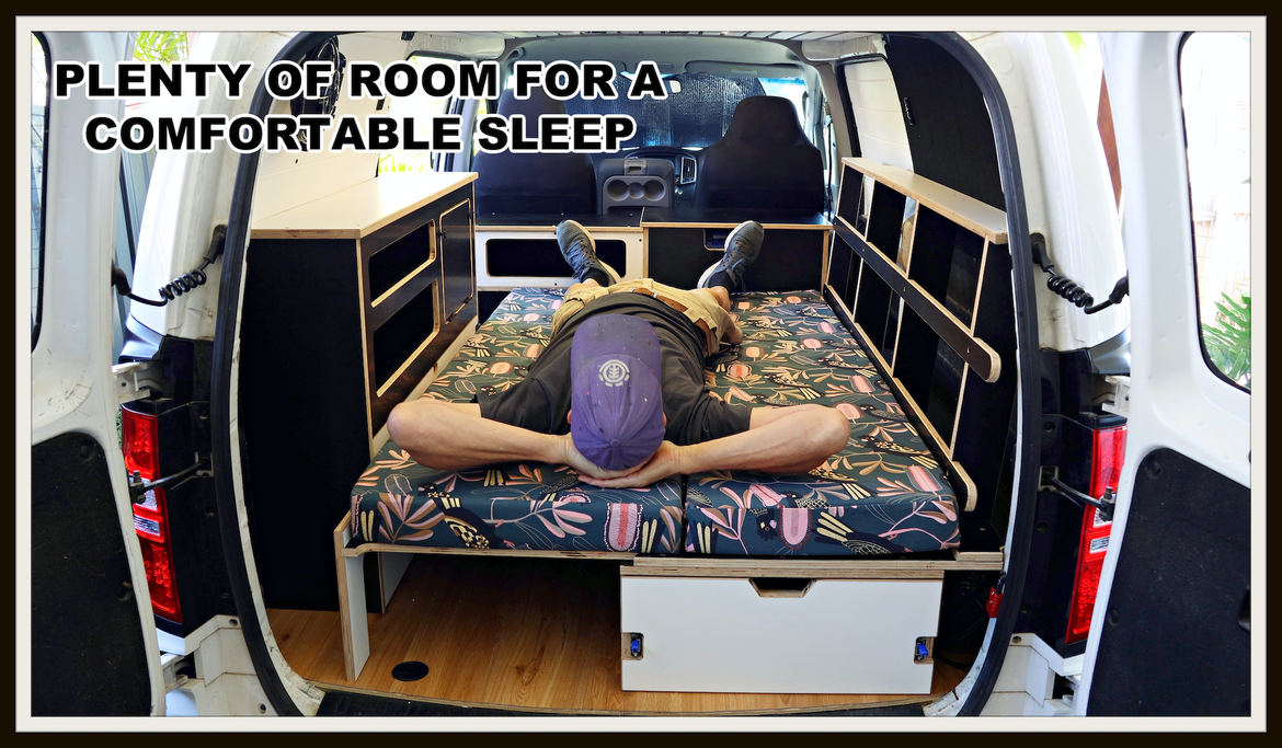

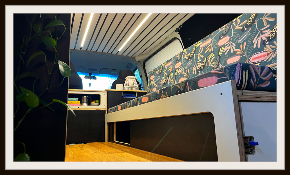

Surfboard storage under the bed stores the boards safely while you sleep overnight.

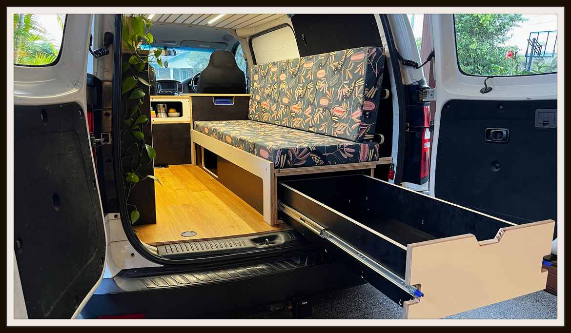

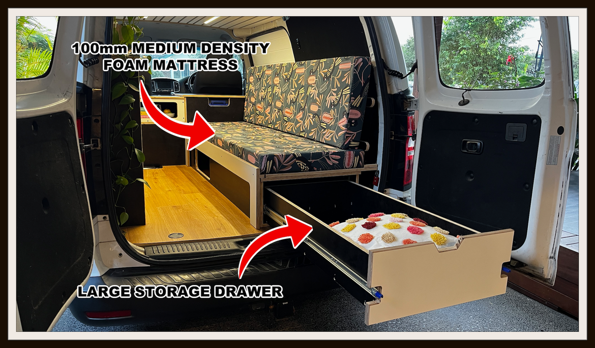

Plenty of storage with a 1 metre pull out drawer and the bed / sofa is very comfortable with a two piece foam mattress.

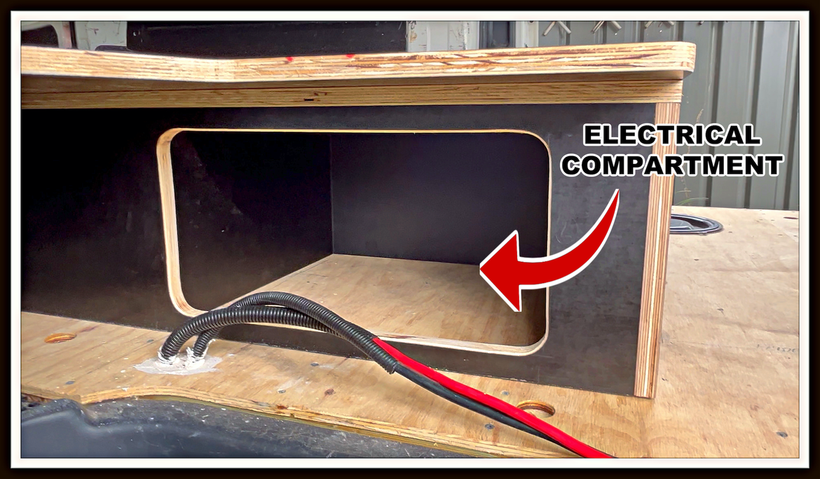

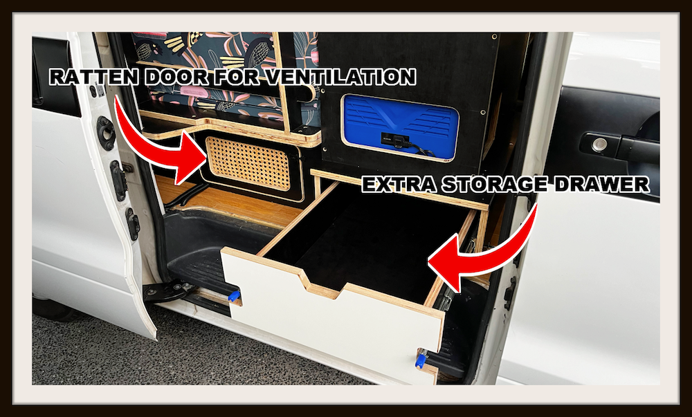

The Ratten Door on the electrical box ensures plenty of ventilation for the electrics whilst the extra drawer provides another handy storage compartment.

I'm a big fan of Four Way Stretch Carpet. Just stick it to some MDF for a luxurious finish.

The VJ was a little difficult to install due to the uneven and curved face of the wall and door panels. A little force was required to secure in place and just make sure that you screw to a panel that is not the outside skin of the van....check twice, screw once. The Black Button Head Screws are nice accent against the white MDF.

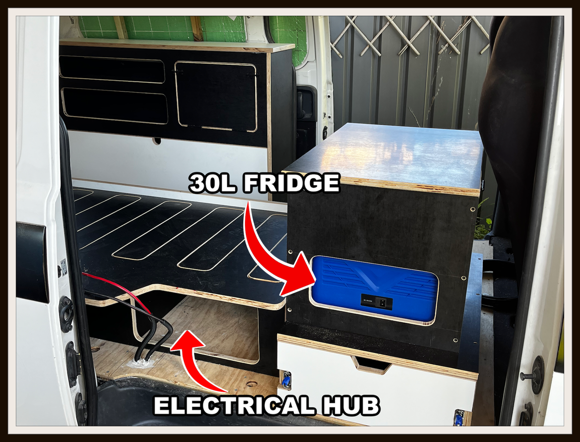

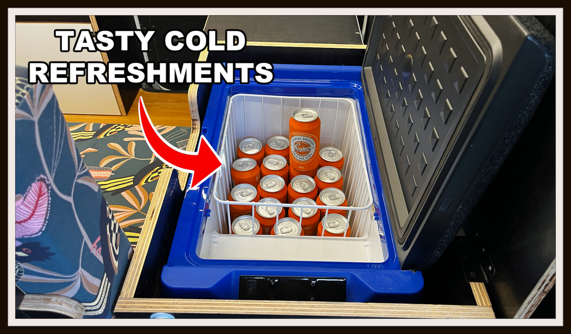

The 30 litre fridge is a great option and keeps those beers just at the right temperature.....delicious.

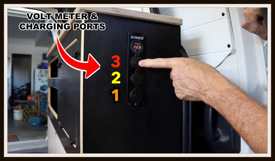

Three styles of charging ports.
1: two USB Ports
2: One USB Port and one USB-C Port
3: One cigarette style Charging Port.

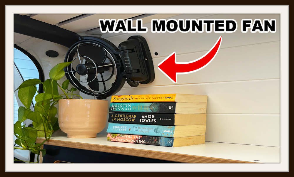

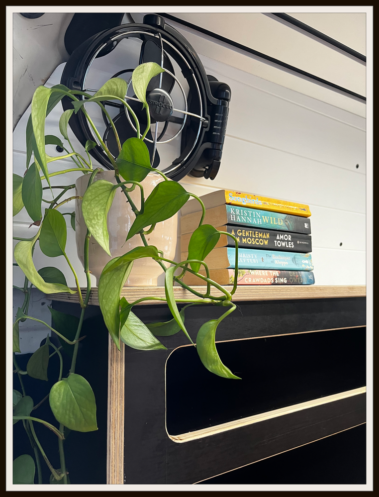

The wall mounted fan is a necessity for a comfortable van life.

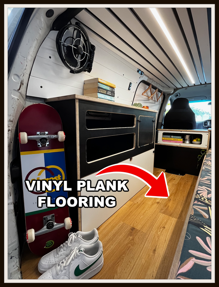

The vinyl plank flooring looks great and is simple to install.

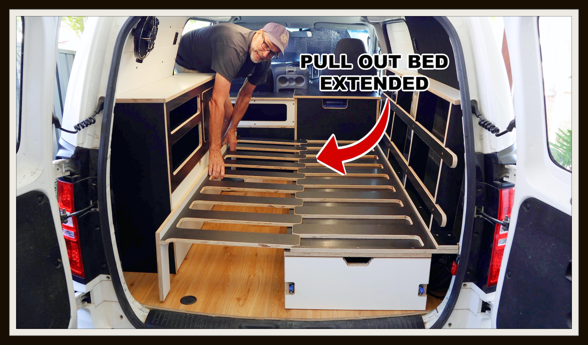

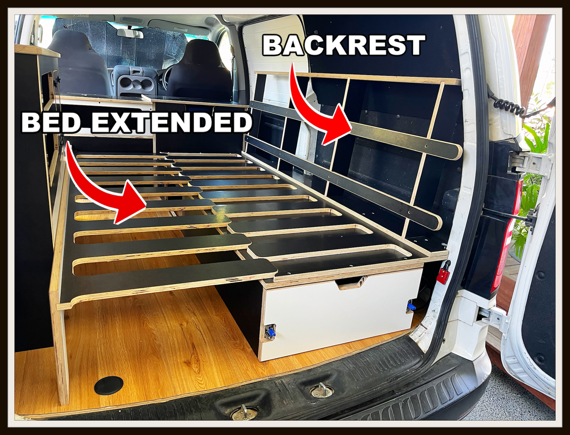

The Pull Out Bed / Sofa is a very effective way to kill two birds with the one stone. If you're interested in making one for yourself you can find the Plans here: https://etsy.me/3WR3w43

The Open Storage is a great place to store your devices, clothing, books etc

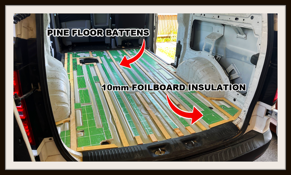

Floor battens glued down to the floor pan with insulation glued in between the battens.

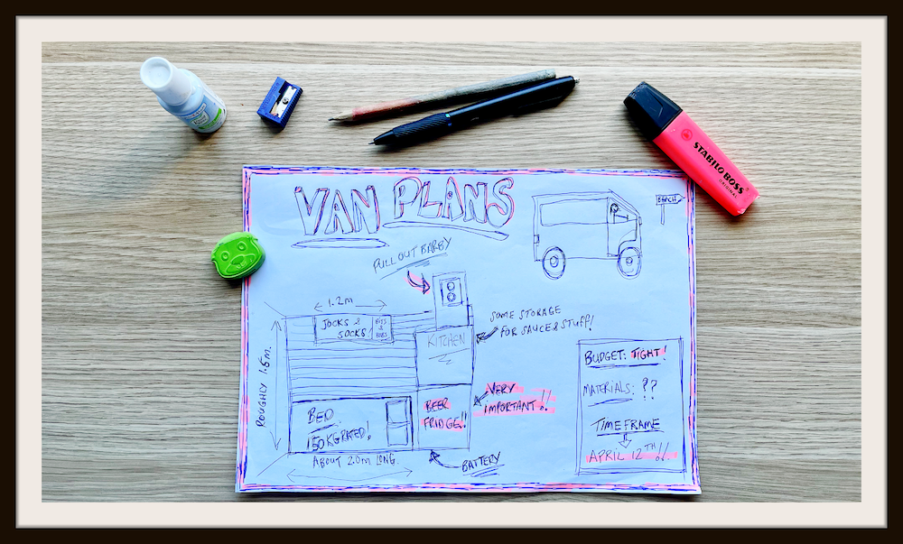

Detailed Plans 😂

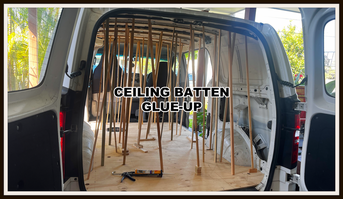

Holding up the ceiling battens till the glue dried.

Timber slats nailed to a 3mm sheet of MDF that l painted black for accent.

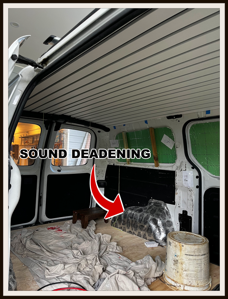

Sound deadening material was applied to the areas of the van that sounded "tinny" These tinny areas were on the wall and ceiling panels and also the wheel arches where road noise is transferred.

Insulating your van is an important step as they can get really hot in the summer and very cold in the winter.

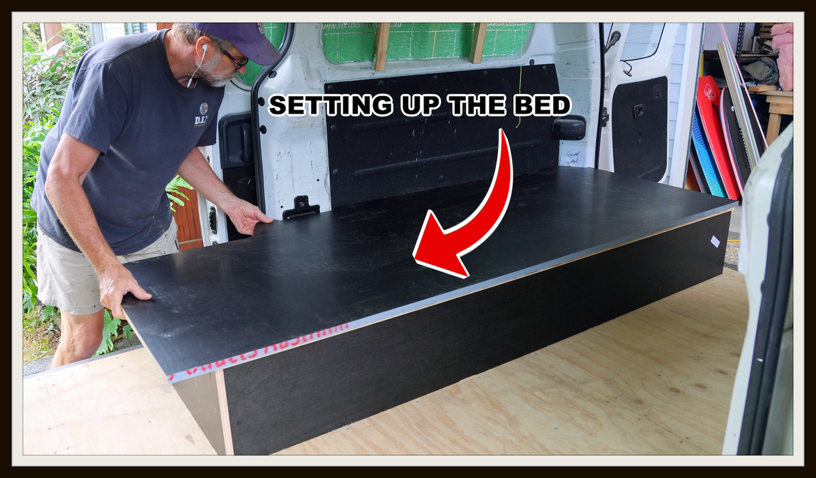

The Bed Box is an integral part of the build as everything else is built around it.

The plywood floor was installed in two pieces. There are so many ins and outs with a van that it would be very difficult to do it out of one sheet.

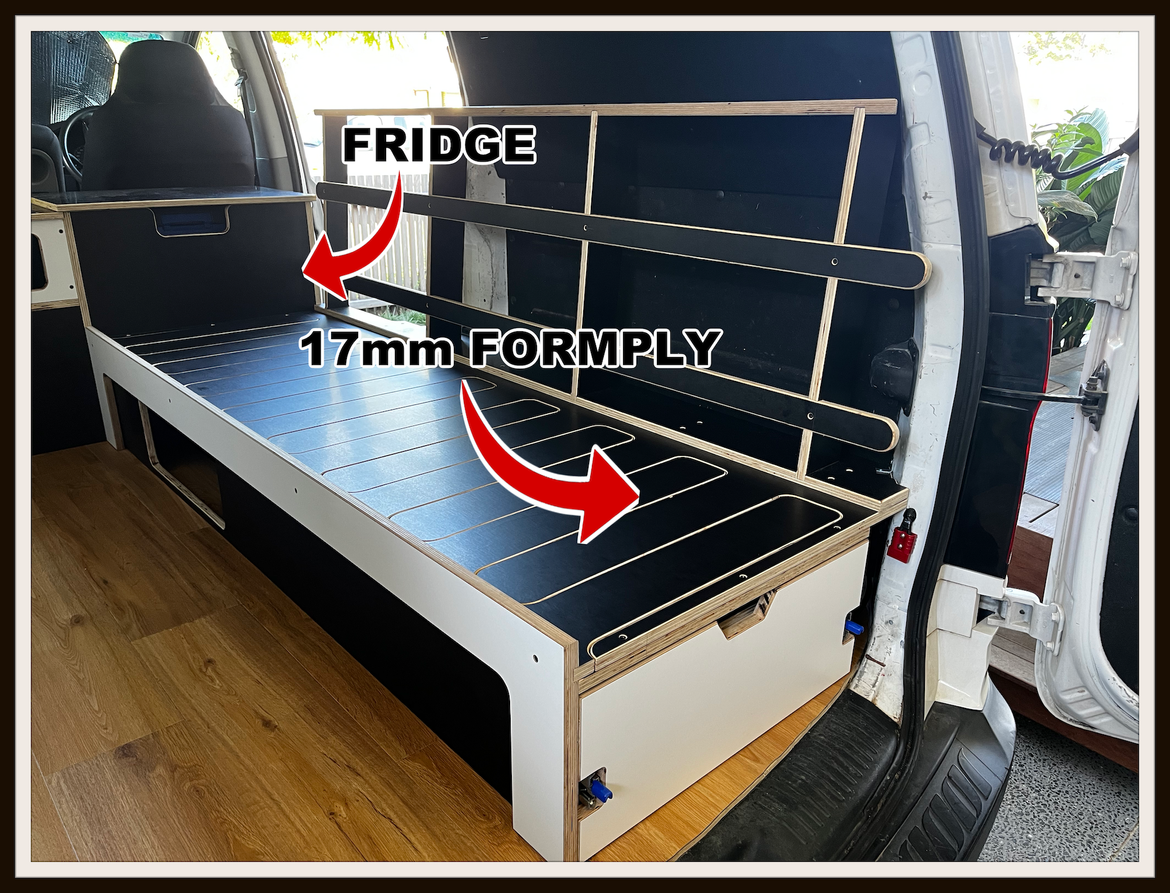

I'm a massive fan of the 17mm Formply. It looks awesome and is generally straight and flat.

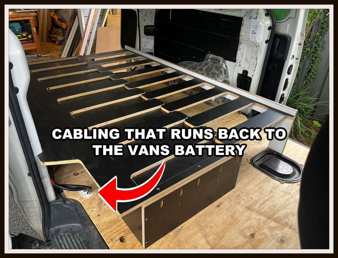

The cabling was a little tricky to run back to the battery but we got there in the end.

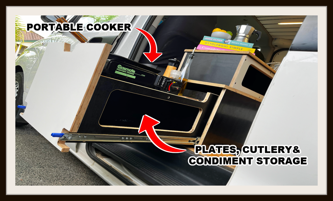

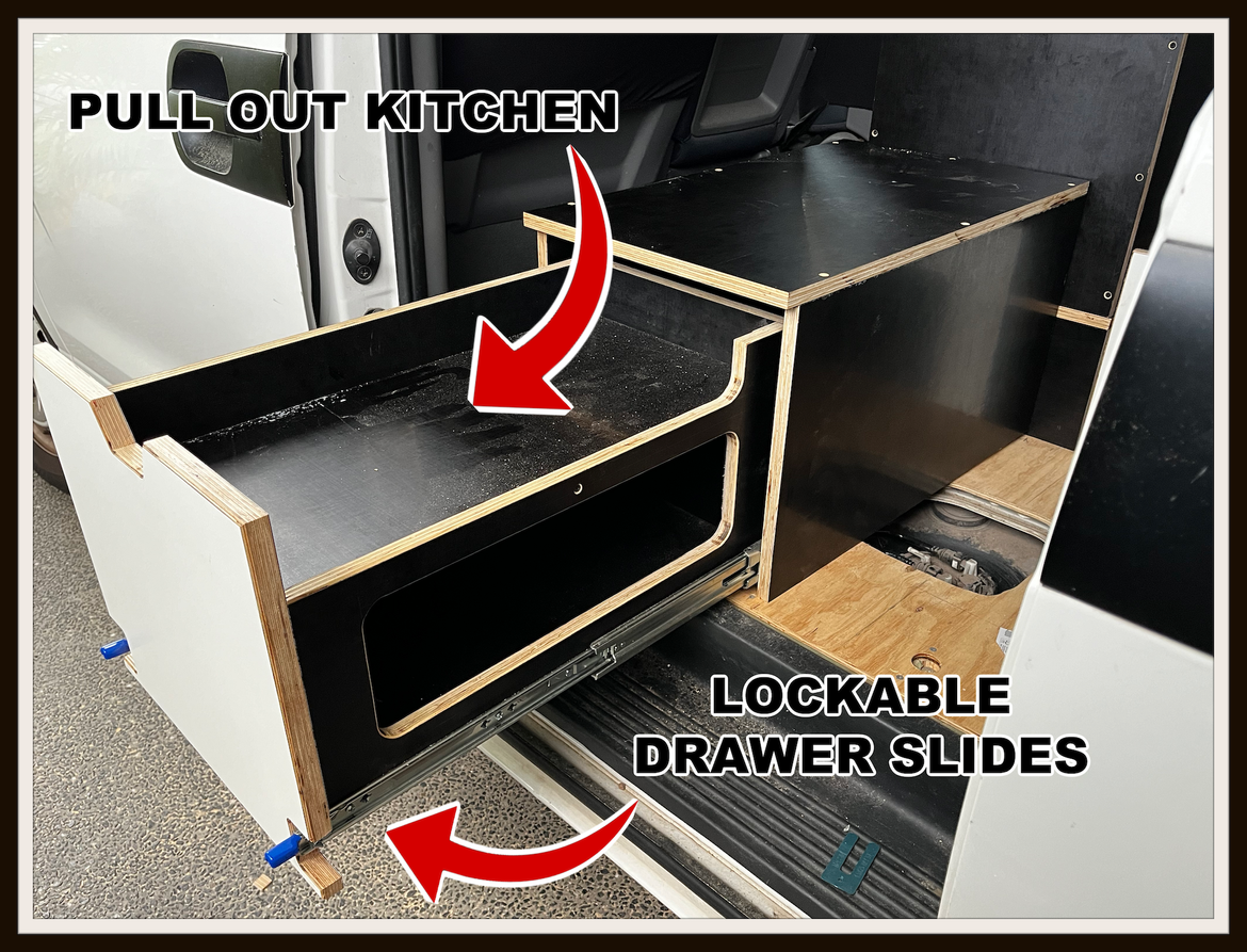

The pull out kitchen works well as a place to use and store your gas cooker.

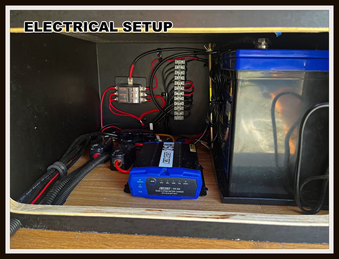

The engine room for all the electrics is located under the bed.
A 100AH Lithium battery runs all the electrics which is charged from the vans battery as well as the solar panel on the roof.
The backrest is a game changer for the pull out bed. You can actually sit in the van comfortably without your head hitting the ceiling!
Having the fridge and electrical compartment accessible via the side door is very convenient.
Hear duty drawer slides work an absolute treat with the drawer. Having the drawer lockable prevents it from coming out when driving.
