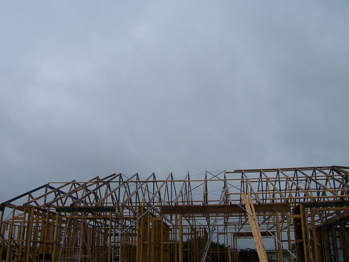

Picture above shows framing in full swing and then came the trusses in the picture below. This part of the project was in my opinion the most challenging of anything else we've done on the home thus far.
The trusses were 12.5m wide with only the slightest overhang on the top plates of I think was only about 10cm or so. To pick the trusses up, we fastened two 8" x2" timbers in old measurements, in the main triangle section of the trusses so as not to compromise the gangnails, we then lifted them up with the trusty front end loader and sat the truss on the east end of the house. Then we fastened a rope at either end of the trusses and we dragged the it from the east to the west, some 17 mtrs initially, lifting or jumping it over the odd gangnail that was in the top plate here and there, until it was right up the west end and ready to stand up. Then we used a long board to start to lift the truss and took up the slack with two ropes fastened at the centre or top of the truss, one rope pulling east and the other west. Slowly aand painstakingly, we loosened one rope and tightened the other rope and mostly we succeeded with each truss, although the odd one slipped off the top plate and we had to re lower the truss, lift it back up onto the top plate by hand and start the lift again. To get the truss back up on the top plate, we had to completely skew the truss, even though we only had to gain that small amount of 10cm.
Fourteen trusses later and we had them up and then there were the smaller hip trusses but they seemed rather easy compared to the main trusses!!!Trusses no 1.JPG
