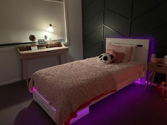

Hurray! I have completed my first feature wall DIY and so far looks great and everyone is loving it.
Re: Need help with color for feature wall in kids room
It looks incredible @sper. Well done and thanks for sharing!
Could you run through the materials you ended up using and how you created this feature?

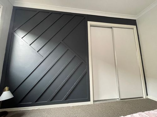

I have completed another feature wall in the 2nd room, this time a different pattern though. Looks amazing with little Dulux diamond glitter applied to the pattern lines. This room took me around 4.5 days to complete. Color is again Dulux Ticking.
Re: Bedroom feature wall
Hi @sper

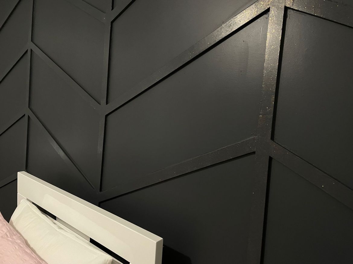

Thank you so much for sharing your feature wall in the second bedroom. You've got the hang of it now. That second room feature wall is perfect and the colour is just gorgeous. Would it be possible for you to take a closer photo of the pattern lines so that we can see the diamond glitter? I'm sure our members are keen to see if the glitter really stands out or is subdued?
Again, thank you so much for sharing your second feature wall.
Hey Eric, I have tried capturing but it doesn't look as good as with the naked eye. but anyway, thats what I could capture.
