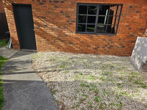

I have soil against garage wall with the garage slab below the ground level. In heavy rains I can see water seeping through the break wall. I was planning to dig a trench and put agi pipe around the garage walls. Just wondering how deep I need to dig and what is the process of water proofing the break wall from outside. Which products should I use?   Thanks.

It sounds like the problem is that the water is sitting in the soil and not draining away. Best practice would have the line of the soil well below the top of the slab, so any sitting ground water is below the level of the slab.
Lowering the level of the soil to below the slab would be the best way to reduce the water ingress, however a trench with agi pipe will help to bring down the water level in the soil and divert it somewhere else.
I would suggest that the trench should be at least 300mm deep and filled with a base layer of compacted drainage gravel at least 50mm thick.
You would also benefit from applying Crommelin 2L Dampstop Concrete And Masonry Damp Surface Moisture Barrier And Primer to the outside of the brick below the soil line. This will prevent the water seepage through the brick diverting it to the agi pipe where it will subsequently be carried away.
Ideally, the agi pipe would be connected to a stormwater outlet so the water is drained away to the council stormwater services. This, however, would require the assistance of a suitably licenced plumber.

I've given 300mm as a general number that should cover most situations. It doesn't look like the concrete slab is too far below the level of the soil so this should be adequate for you. If the photo is deceptive and the concrete slab is much lower, then you would need to go deeper. The goal is to give the ground water a point below the brick line to drain to. If the drain is above the brick line, then water will still be present in the soil at the brick line, meaning it will find its way into the garage.
Silicone such as this Sikaflex 11FC Plus between the bricks and slab would also be beneficial as it is adding another layer of protection that will stop the water finding an entry point.
The bricks should definitely be cleaned down, preferably with a pressure washer, but if you don't have one available to you, a stiff bristled brush with hot soapy water should be fine. The idea is to remove any loose material or dust that can limit the waterproofing membrane's ability to stick.
Once clean, paint the Cromellin Dampstop on following the manufacturer's instructions for best results. The idea is for the membrane to form one solid barrier the full length of the wall which will stop the water touching the bricks making it run down into the drain.
In other situations that are different to yours I would recommend corflute, but in your situation the Cromellin's Dampstop should be adequate by itself.
