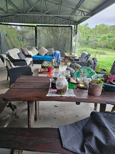

I want to screen enclose and vermin proof the open sides of my outdoor shed. My research tells me Australia has no screen tight type product, so that means aluminium screen rails which come in 5 mtr span, while my openings will be 6 mtr. Or does it? Could I roll the screening onto 6mtr thin timbers perhaps and tackle those onto a frame?
Is pet resistant screening also vermin proof or do I need to put vermin proof wire on the lower section, then screen the top?
Space is 12x6mtrs with one end and half one side closed in, so 2 panels are 6x2.4 and 2 panels will incorporate a sliding door (2.4x2.4) probably. Leaving .600x2.4 in 2 remaining sections.
Any thoughts?
