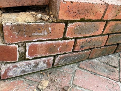

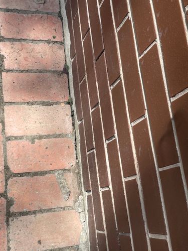

Hi guys, I need some help fixing some stuff around my home. Could anyone please suggest what kind of material is required, especially for pavers.
1. retaining wall, some of the bricks are loose

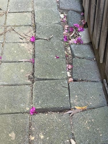

2. pavers

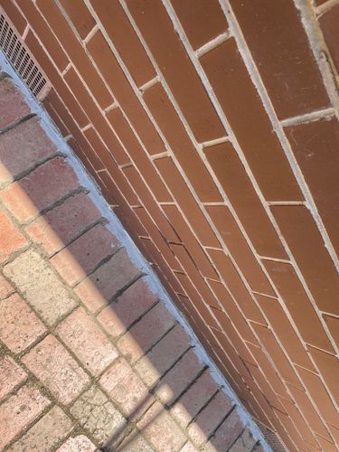

3. Crack at the bottom of wall
I’ve tried some Brunings paving sand previous. However the results were not favorable, it just didn’t harden enough to settle. I tried mix some cement too but it came loose after some time.
Appreciated your help in advance, thank you

Welcome to the Bunnings Workshop community @handynoob. It's terrific to have you join us, and many thanks for your question about making repairs.

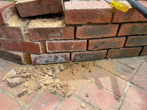

To fix the retaining wall, start by carefully removing the loose bricks and chipping out the old mortar using a mini sledgehammer and cold chisel. Once the area is clean, re-lay the bricks with fresh mortar, ensuring the joints are well-filled for stability.

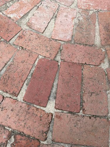

For the pavers, lift the affected ones and add new sand or mortar beneath them to raise them to the correct height. Compact the base material before replacing the pavers to ensure they sit evenly.
The crack at the bottom of the wall is likely caused by movement between two structures. Filling the crack with a flexible sealant like Sikaflex 11FC can help accommodate this movement and prevent further damage.
Lastly, for the paving gaps, avoid using rigid materials like cement, as they will crack over time due to natural movement. Instead, periodically refill the gaps with fresh paving sand to maintain a neat and stable finish.

One think bothers me is the gaps between the brick pavers appears to be large, I've read to mix sand and cements, 3:1 part, however, the results were mediocre. It was done like last week, and I can see the sand coming just not binding enough. Should I increase the ration of cement for next time?

Hi Michell,
Using a chisel and old flat-head screwdriver, old mortar is crumbling away like damp sand.
Wondering how deep should I clear old mortar. Should I clear all the way or half way?
Thanks
Re: retaining wall maintenance
Hi @handynoob,
It would be best to clear all the mortar out as anything you add will be bonding to what is left there. Having all new material will ensure it is all uniform in nature and will give it the best chance of surviving as long as possible.

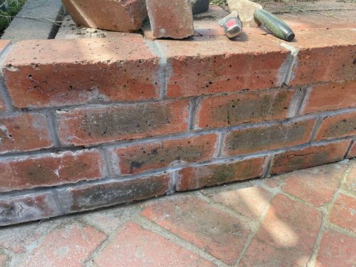

Hi @MitchellMc
completed repointing with sand cement lime. Also used sikaflex to seal the bottom of wall.
looks better than I expected, now, how would I clean bricks.
I’m using hydrochloric acid for mortar, would it work for sika sealant as well? Or do I need rubbing alcohol?
Many thanks
Hello @handynoob
I suggest using Builders Edge 750ml Cement 'N' Concrete Remover instead of hydrochloric acid. It is a cleaning compound designed specifically to remove dry mud build-up and stains from a variety of substrates with a safe approach. Using the acid to remove the Sika sealant is not advised as it is too corrosive and will damage the sealant all the way. I suggest just cleaning the bricks and leaving the Sika sealant alone.
