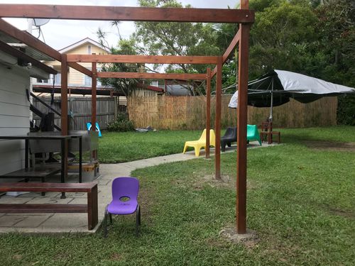

How to level around the pergola posts to install pavers?
Jimi77
Re: possible to level around the post in the ground so i can put down pavers?…Would i pack down sand
Hi @Jimi77,
My advice would be to remove a small amount of the soil, add a layer of road base, and compact it with a tamper. Check out How To Prepare And Lay a Base For Pavers for some guidance on foundation prep.
You can then lay your pavers on top using paving sand or mortar as a levelling material. Check out How To Lay Pavers for guidance on this step.
