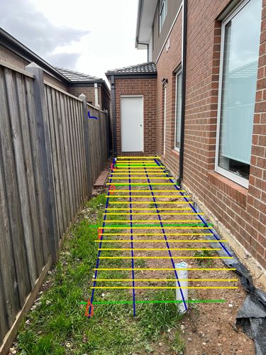

I have attached a rough plan
RED- posts are 1.5 apart 100x100 h7 Cyprus
GREEN - bearers 145x45 post to slab
BLUE - Joists 45x90. 450 centre to centre
YELLOW floor board

Your plan looks quite good, but remember you'll need posts supporting the middle two bearers as well.

So you advise more posts for the middle 2 bearers? The length of the bearer is 1.5. That span from post to ledger shouldn’t need another post should it? I could Throw in a tough block it’s low enough.

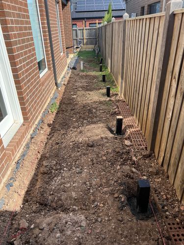

posts in today image updated

Sorry, my mistake. The bearers spanning the 1500mm are fine.
